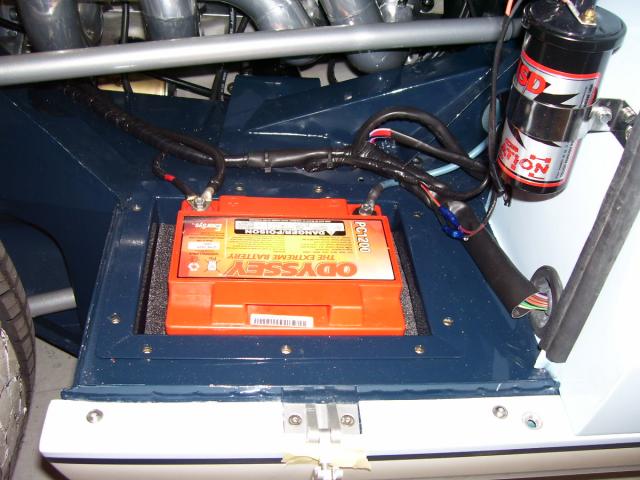

Odyssey sealed battery

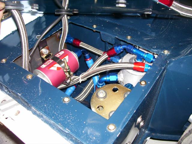

Swirl pot sump (Large Canton filter, seperate Carter pump taking suction from tanks and constantly filling/overflowing the swirl tank return to tanks providing constant supply regardless of down shift of car from horizontal) by Olthoff
