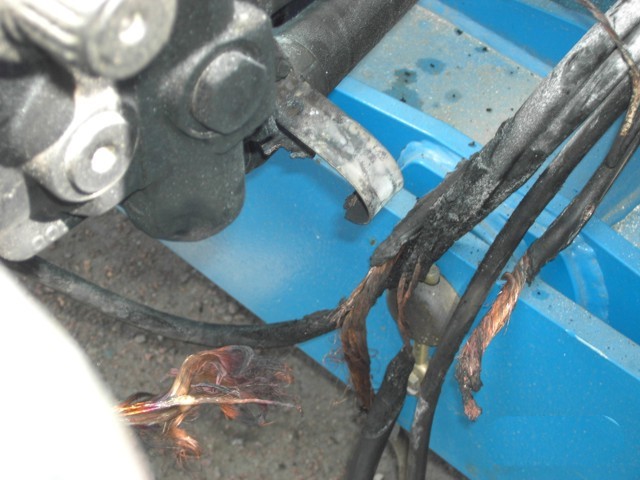

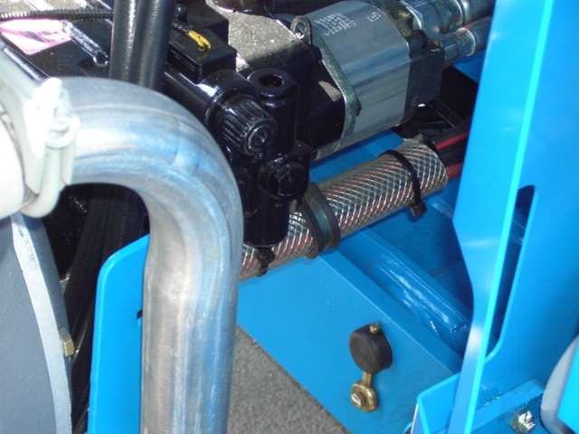

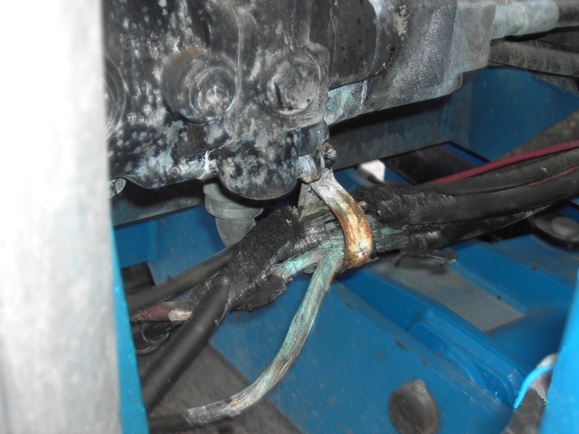

Just a reminder to carefully consider the use of P-style clamps and how you’re routing wires and hoses. The pics, well, pretty much speak for themselves.
