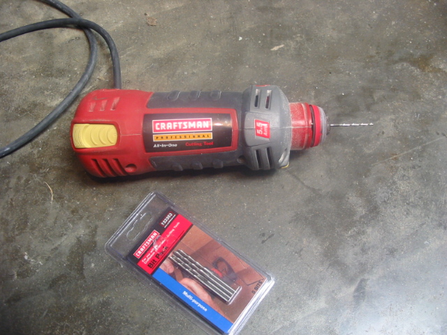

Dean:
Used a Sears Cutting Tool with a multi purpose / fiberglass cutting bit. Works great, but one needs a steady hand.
