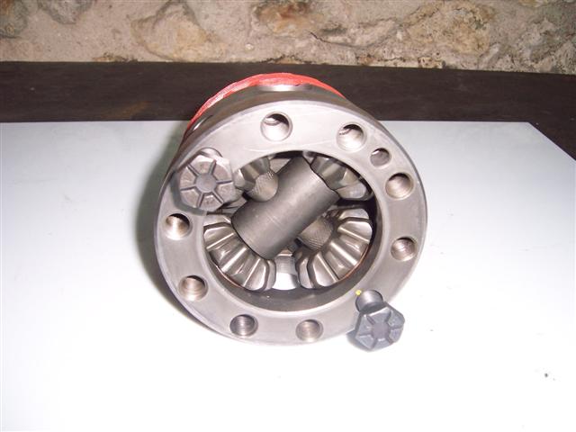

Pic 1 is a view of our comon 2 pinions differential.

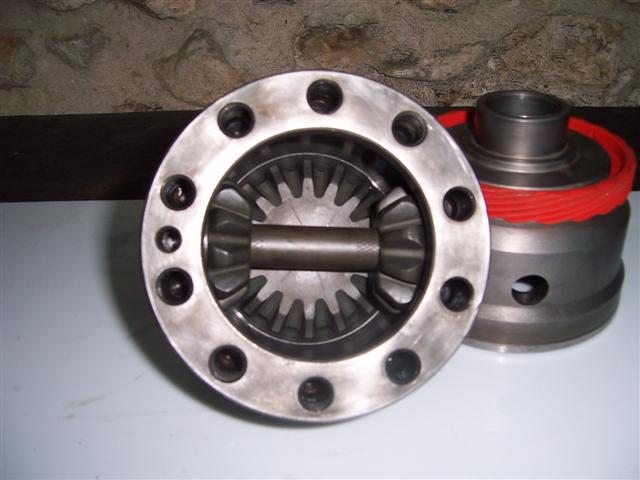

Pic 2 is a view of our upgrade kit allowing to fit 4 pinions.

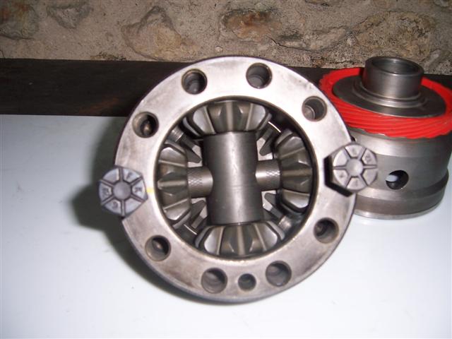

Pic 3 is a view of the kit installed in a differential (R25) with an electronic sensor.

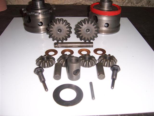

Pic 4 is a view of the kit installed in a differential (R21) with a mechanical sensor (UN1-13)
