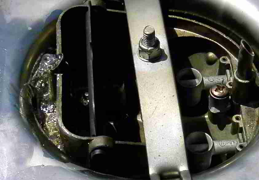

The next day when the engine was cold I removed the air filter and switched the fuel pump on for 2 seconds. Fuel was pouring out of the vent from the primary float bowl of the Holley carburettor.
When I removed the primary float bowl I found some corrosion, so it is likely that this caused the fuel valve to get stuck in the open position.
