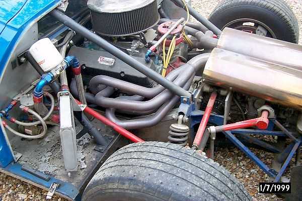

The RF cage looks very impressive. I'm currently working on fitting a roll bar to RAC spec & can appreciate what alot of work is involved in getting it all to fit.
I found this pic a while back somewhere on the web & it shows a GTD with roll bar rear stays that mount onto the damper pickups, which I guess must add a great deal of rigidity to the chassis.
However it does create problems clearing the exhaust manifold. Also check out the upper suspension pickup points...

I've done my GTD very much like Roy Smart with two hoops and a dual central logitudial brace. The difference is that I ran the forward uplinks to the hoop right along side of the eyeball vents and mounted to the top frame rail with a four bolt mounting plate. The rear hoop is thru bolted to the headrail near the upper corners via welded in threaded bungs on the roll over tubing and a pass thru bung in the header rail and is mounted to the same frame rail with another 4 bolt mounting plate. I thought at the time that I designed it that I would be able to remove it from the car if need be. Almost can but it is just too big to get out the door opening. If I had to do it over I would make it so the two hoops, front and rear unbolt from each other in the center of the double longitudal tubes. I also like the braces in the picture of the GTD with the chevy in it. I think I will make some and bolt them to the header rail and the upper damper mount at a later date if there is room and I dont have to modifiy my headers. If I can figure out how to make the pictures smaller then I will post them.
