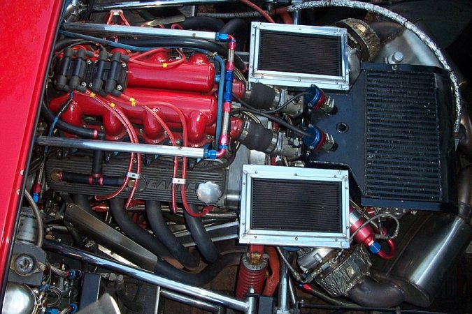

Re: Horsepower
A few pictures of the car and engine.
cos is offline

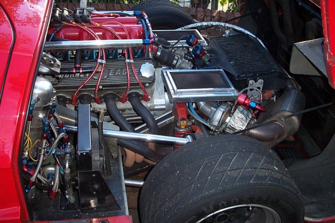

Re: Horsepower

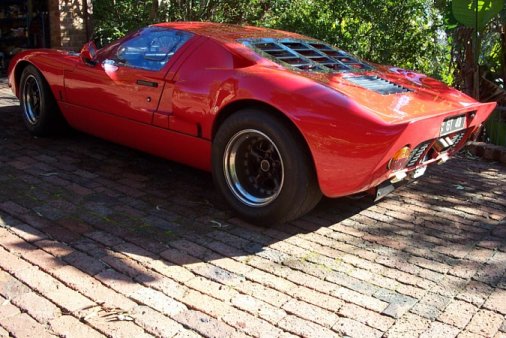

Re: Horsepower

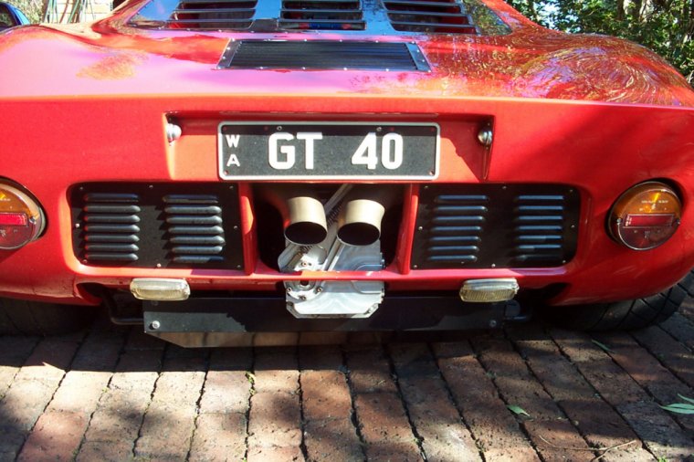

Re: Horsepower

Cos, that is a sweet setup. Congratulations on an extremely well-done GTD. Care to tell us about your gearbox? Where do the intercoolers draw fressh air? How much horsepower does your engine make?
Nice to see you post here...I've heard about your car and have wanted to see it.
