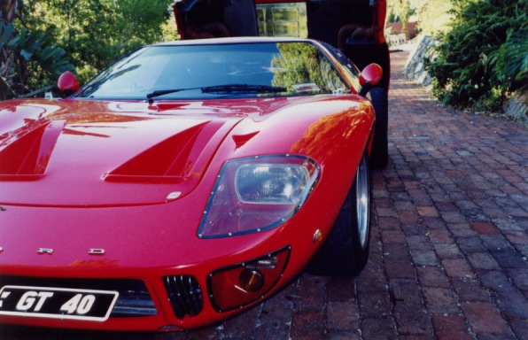

Hi Cos
Welcome to the forum, I still talk about the time you took the misses and I for a Sunday drive!!!! Not only does it push you back into the seat but up the incline as well. Just plain awesome in my books. [img]/ubbthreads/images/graemlins/shocked.gif[/img]
regards
Clayton
