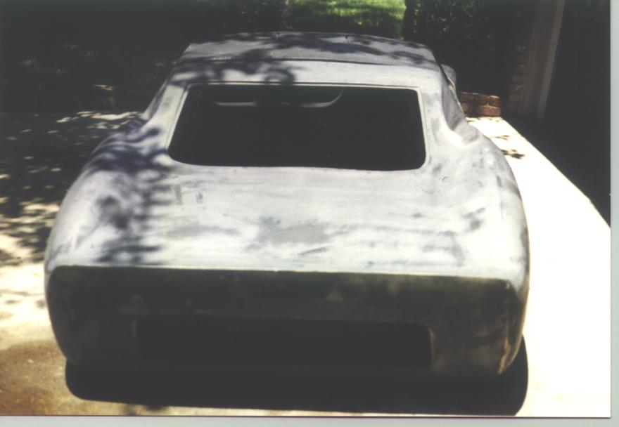

Here are the pix of my body when I got it. [img]/ubbthreads/images/graemlins/cool.gif[/img]
Name:	25155-GT40 Body4.jpg
cobra1 is offline

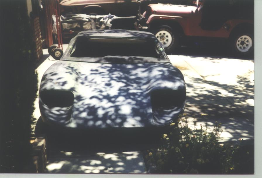

#2 [img]/ubbthreads/images/graemlins/cool.gif[/img]
Name:	25157-GT40 Body3.jpg
cobra1 is offline

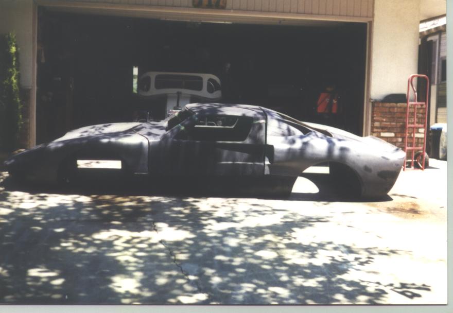

#3 [img]/ubbthreads/images/graemlins/cool.gif[/img]
Name:	25158-GT40 Body2.jpg
cobra1 is offline

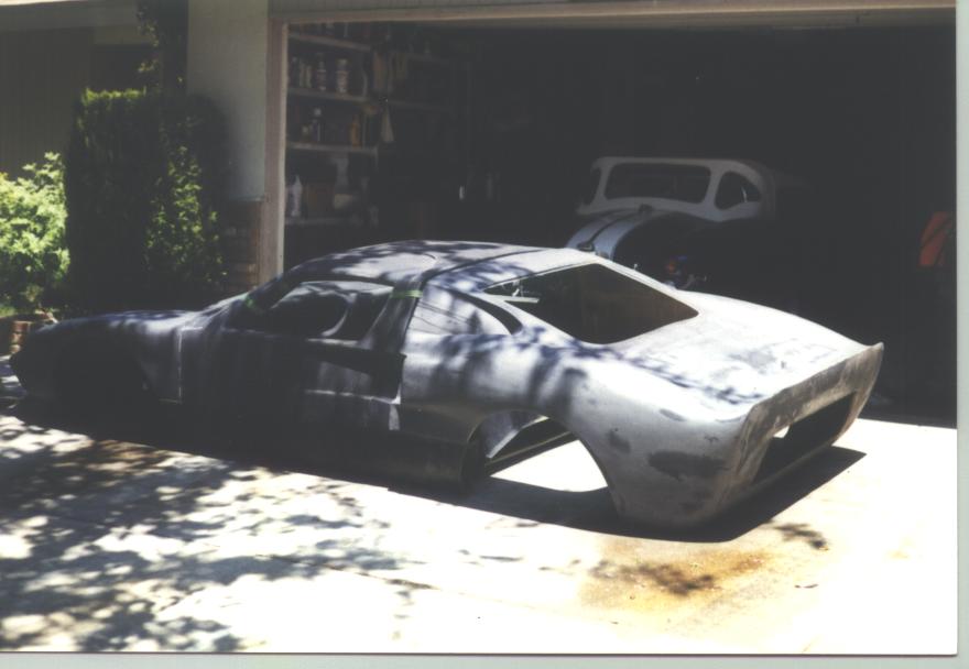

#4 [img]/ubbthreads/images/graemlins/cool.gif[/img]
Name:	25159-GT40 Body1.jpg
cobra1 is offline

Neal, the reason for the weird look from the cockpit back is that these cars were designed to use one of the few transaxles that were affordable back then and stronger than a VW: Corvair. Now the Corvair is not built like a ZF, Porsche, Audi or most any other that places the diff between the engine and the gearbox. The Corvair was just an in line transmission and diff in a single housing. With the diff way out behind the transmission, you get a helluva distance between the front of the engine and axle line in the back. Hence the big, long rear clip from the wheels to the back of the doors. (I guess this is the B pillar area; I think I know that the A pillar is the the post beside the windshield, right? [img]/ubbthreads/images/graemlins/confused.gif[/img] ) Nothing says you have to use Corvair today.
To my way of thinking, right now, the Audi 5000 is the cheapest transaxle. If you put a dollar value on torque handling ability, I think the Porsche 915 or maybe 901 would be it. Only thing about 915s is the cable clutch. That can be re-engineered to hydraulic. I know at least one guy who has done it.
