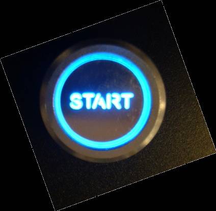

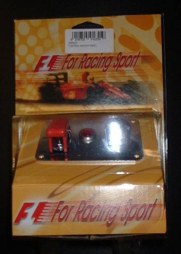

a company i deal with do astarter kit a starter button and a fighter tyle ignition swtch with flip lid on an alloy backing avaliable in the uk for about £30 they also do an alloy blue led starter button which can be flush mounted if you would like any more info please e mail me on candc@ic24.net chris
Name:	25786-starter swich plus button1.1.jpg

the other pic
Name:	25787-start switch lit1.1.jpg

Hey Chris, is that one of the Trilogy buttons that Demon Tweeks have in their catalogue? If so, could you measure the radius edge. Thanks
Brett

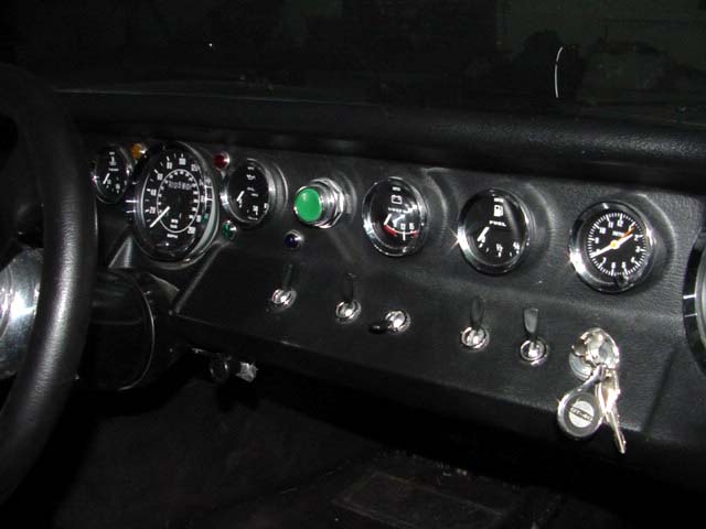

I also have a starter button in my RFGT40. My Dad had this
button in a drawer. He saved it from a large delivery truck with a lift gate on it. This was one of the buttons that raised the gate. I thought it was perfect for the intended use as it is green for go and not red. It also fit the hole that was already there so that made it even nicer.
Chris at the RF factory, who is the electrician, gave me the instructions on how to install it. Works great.
Name:	25817-starter button in dash.jpg

BRETT YES IT IS ONE OF THE TRILOGY SWITCHES THEY HAV A 25 MM DIAMETER IE A 12.5 RADIUS IF THAT HELP THEY CAN ALSO BE FLUSH MOUNTED AS THE ALLOY SIDE BEZAL COMES OFF LEAVING A VERY FLAT SWITCH
