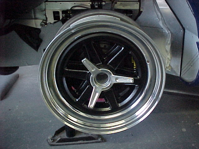

Here's a 16 inch Jongbloed.
As recommended by the late Carol Smith.
J.P

JP, wheel looks very good, but I'm a bit worried that the spinner seems to be engaging on only two or three threads of the stub axle. [img]/ubbthreads/images/graemlins/shocked.gif[/img]

Correct. We've made some new hubs with extra thread. The wheels were made very thick to accomodate the huge AP brake calipers.
J.P

Wheels look great. How do you go on with an SVA in the uk - this is the only thing putting me off ,as I thought you were'nt allowed spinners these days.

This particular set are in fact designed primarily for track use. For SVA it will wear nuts with the correct radius, in fact I will not be using spinners on these at all.
I'm having another set made early next year which will be of a heavier construction just for the road.
I have asked Bill Jongbloed about lightweight wheels on the road. He reckons they'll be absolutely fine as long as I don't drive over any pot holes. Well I guess we all know our local roads so that's an easy one.

I'm also running Jongbloeds. 16x9.5" fronts, 17x12" rears.
2500 street miles, no problems. There is a bit of tire sidewall to absorb impacts. Big hits may bend the spun aluminum rims, but they are pretty robust. Mine use an aluminum center casting rather than Jongbloeds magnesium centers. The neat thing about these wheels are that you can have new rim halfs or different diameter/offset rim halfs spun to fit the centers.
Safety wire the spinners because if they are like mine, they will come loose.....in less than 10 miles.

Your knock offs should not come loose that easily! Check to be sure that the taper is fully seating into the wheel taper. I have seen some wheels where the spinner bottoms on a shoulder before the tapers are fully seated on each other.
