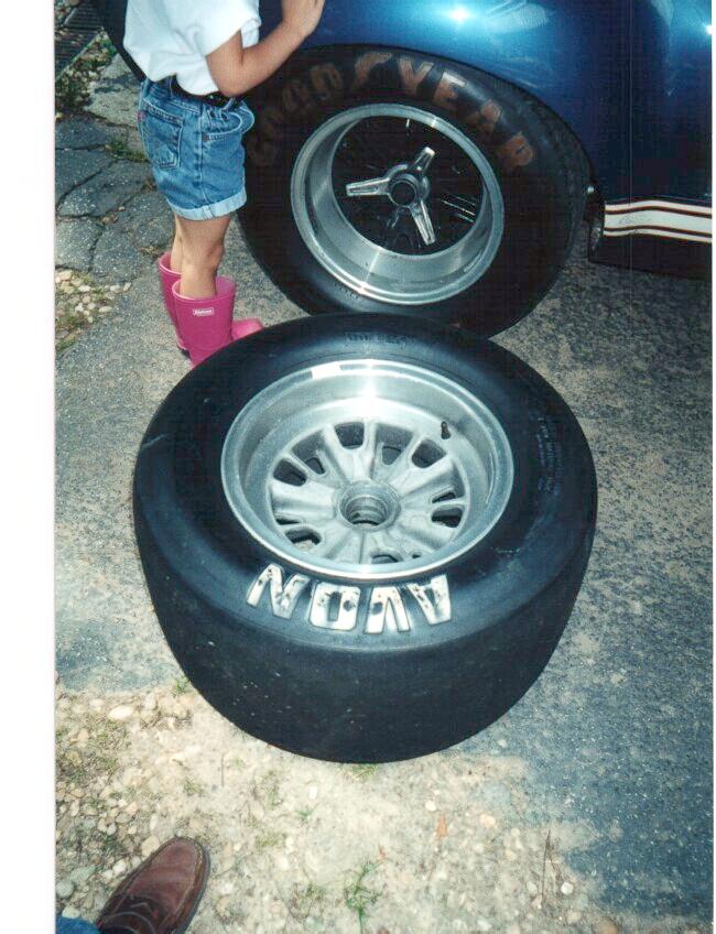

I run Goodyear Blue Streak Sports car specials (8.00x15 rear, 6.00x15 front) bias ply race tires, and I run 21psi cold in the rear and 19 psi cold in the front. This is also what we run on George Stauffers cars. Seems that you are running way too much......? It would be like driving on ice. Proper pressures can only be determined for serious track driving by taking the temp of the tire across it's tread right after running and trying for even heat from one side to the other and from one tire to the other (same axle). Hope this helps.

Not Road Legal, and they rarely make them with real treads any longer. They drive like crap on the road, but are the tire of choice on the track. I like them better than the stickier Avons, as the car slides around at a predictable rate rather than coming un-glued in an instant. If you have more than 1 set of wheels, then by all means, mount up a set and give it a go.
