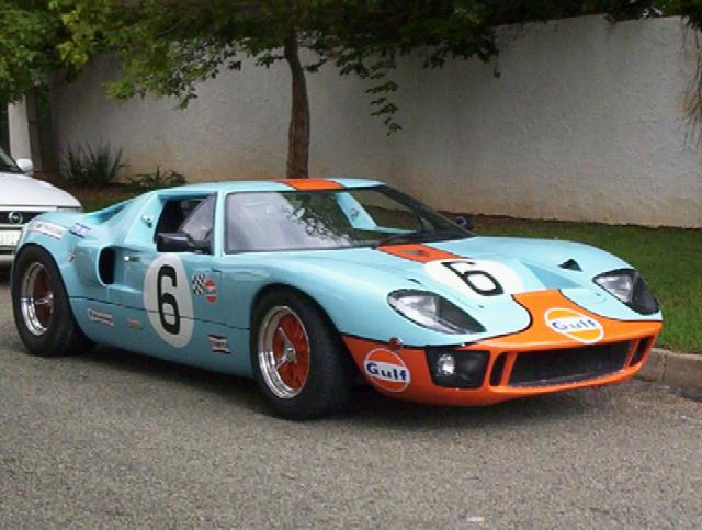

Judging from the panel gap fitment it is a well made car,
with nice neat fitment of the panels, but in my opinion there is far to big a gap between tyres and body - makes it look too much like a high rider 4x4 - and the 1964 style nose is not as nice as the '65 onwards - overall it looks well made though.
Speaking of Gulf Gt40's heres a pic of my replica - it's for sale www.charlieb_sa@hotmail.com
+- $54 000
