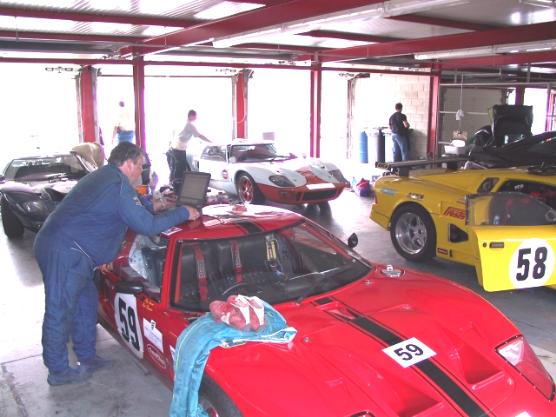

Simon -
Have no fear! - I always remember climbing out of Roy's GTD in the top paddock at Wiscombe to the amazement of the marshalls who could not believe I fitted. (5-11 / 250+lbs)
In fact they asked me to get back in just to prove it! (bloody cheek)
On another note - I recommend you always wear suitable footwear - preferably race boots as the last thing you want is you feet getting tangled when you most need to brake!
Me at SPA 2001
