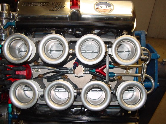

Kalund D & Blackjack:
After two hours and help from Rick Merz here is my first attempt at a picture. It hopefully shows the rear water jacket plumbing that my engine builder did to avoid the steam pockets on the engine I'm running in the Cannonball.

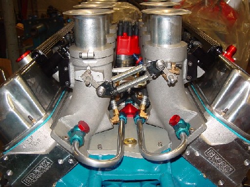

Kalund D, Blackjack & Jim:
Another view.
