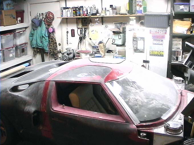

I have finished Betty's boob job. As you can see she no longer has the two Gurney bubbles. I like the car a lot better with the classic roof line. I have a few more hours of body work left and I will have the painter over for inspection. I suspect I will have more work to do after that but all in all shes getting pretty close to paint.
I started a couple days after Christmas, 2003, and have worked about 15-20 hours a week on aveage. Learned a lot about glass work. LOTS of dust!!!
One other thing I couldn't post on the builders page because the Post button was turned off, strange. Works ok here.

If you all recall I kinda asked for a informal poll on Betty's two bumps last year. Just about everyone didn't like two on the car including myself so I took them off. Each door took me about a week. I layed about 3/16" of glass mat into the holes and filled in the rest with a thin coat of Vett panel adhesive to reshape the top. This added about a 1/2" of headroom. The driver's side door bump will soon appear on another 40. So Betty is a boobie donor.
Peter, I used your method of laying 1/2" strips onto the edges to add edge lenght and then overlaying more glassmat to add thickness. You are right. This method really builds up the edge AND has a lot of strenght. I wonder how much the other builders, RF,MDA,CAV,etc., bodys need this much work to make them fit nice.
I added material to at least 90% of the edges on the whole car! Some as much as 3/8". The area at the trailing edge of the doors was the worst. It was necessary to add almost 1/2" of thickness and 3/8" of lenght there. Also the close line at the front of the doors was quite a bit of work also.
I am 5'3" with my shoes on so my problem was to reach the peddles. I moved the peddle box rearward as far as it would go and welded hoops onto the peddles themselfs that added another 1". My seats are not adjustable. I bolted them to 1/4" X 1" steel strips that are inturn bolted to the floor. This places the seats as close to the floor as they can be.
I am still shooting for a return from paint, I could never paint a car myself, by the middle of July. Then I will need to reassemble all the stuff that comes off for painting. I will be gone for the first two weeks in August but look for a comming out party in N. Calif. after that. More on this, Date, time, address, directions, later but if you got em' drive em' over for a afternoon of burgers, beer and 40's.
