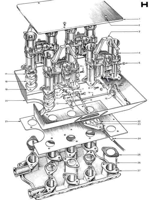

Don’t know if these are the parts everyone is referring to but if someone is making them I will be interest, picture is from the parts manual

That diagram was awesome Pedro - thanks.
