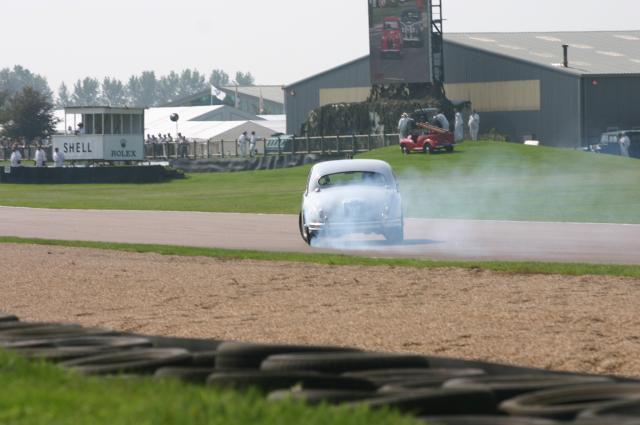

According to Malc (and a few others) - I sometimes drift Roy's 40 through the fast right hander at Lydden. It does'nt feel like it inside the car and I certainly do not consider myself 'experienced' or 'professional'. I do think however that some of the drifting at the revival meeting Malc refers to is down to:
a) the control Dunlop treaded tyres all were using.
b) a certain amount of 'show-boating'
c) most(not all) of the drifting cars were front engine - RWD - try it to the same extent in a 40 and 'BEWARE'....

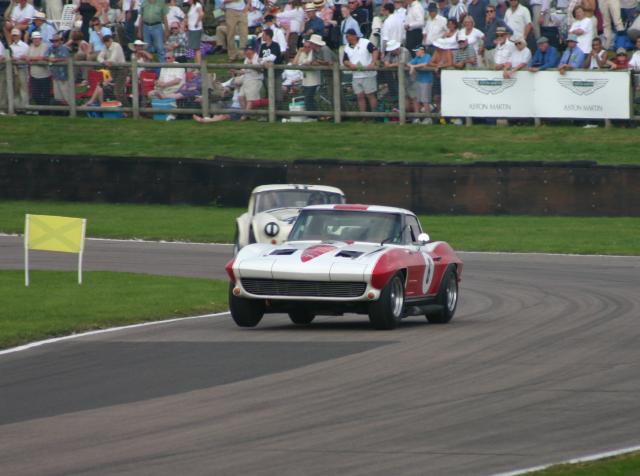

Talk of the Devil -
The Corvette Malcolm refers to exiting Madgewick.
I wonder how easy it is to drift on three wheels? [img]/ubbthreads/images/graemlins/grin.gif[/img]

That would be a 1963 coupe Corvette. Wonder if he was still running the 4 wheel drums ? 4 wheel disk didnt appear till 65.I owned a original 63 for 12 yrs, good cars.
