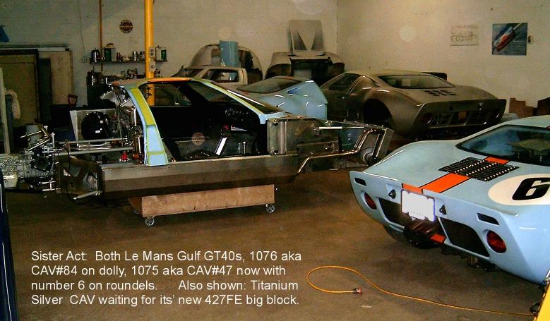

Had to share this one with you. We are completing the reproduction of the sister car of the double Le Mans winner from the first CAV shipped after the Autofutura take-over.
Since there have been so many calls about build quality in the new cars, I'm very pleased to say the new cars are at least on par with the previous production.
This is also the first CAV to have right hand drive and right hand shift for ZF application. We've endevoured to make the shifter placement as correct as possible given the path the shift rod must pass through the monocoque. See the Technical forum for additional picture.
I can hardly wait to get them both outside! Oh yeah, we are putting #7 on CAV#84...

Some guys have all the fun! I was wondering when we would see the latest from CAV Canada. Keep the pictures coming during the build, and thanks for all the help on my ZF conversion.

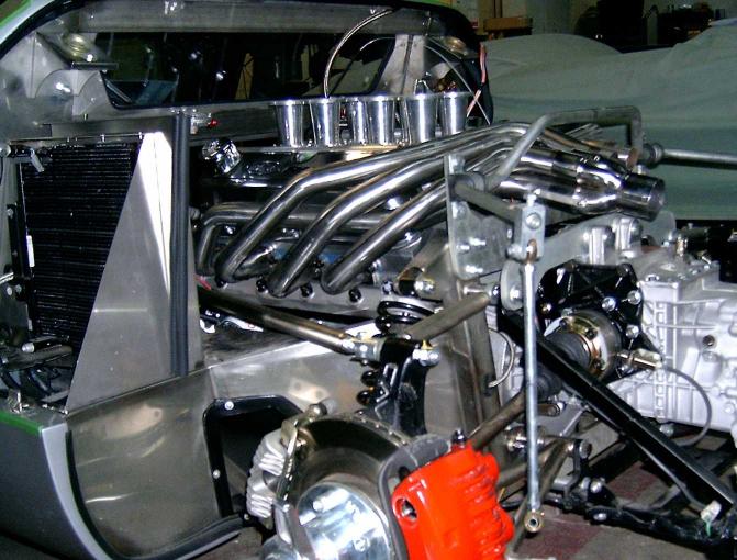

Wow! Nice low motor! Wet sump or dry? 302 or 351 block?

Hi Gary, Wondering who'd pipe up about those low stacks! Here's another pic. It's a 347 crate from Ford Racing with the Australian FI system from Wayne at VeryCoolParts.com.
The engine is in the correct (lowered) position and has a highly modified Canton wet sump pan to make the clearances. Big difference from barely being able to see past the Webers on Frknfast's 392 It's all great fun though...

ZF gets that thing quite low, good choice.
