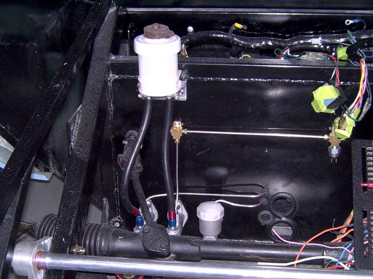

What type of master cylinder are you using? On my DRB we use dual master cylinders for the brakes so biasing adjustments are much more straight forward. Would it not make more sense to change to this type of system (standard race car type)?
dave

I think the "standard" Sabre, like the "standard" DRB
uses Corvette power assist master cylinder with hanging
pedals.
MikeD

Mike my DRB setup. Twin cylinders

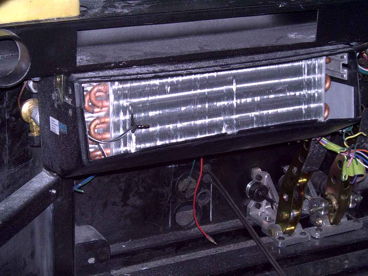

And the pedals.

Last I checked, the Corvette arrangement was "standard"
DRB and the Tilton arrangement was an extra cost option.
I'm also going to use the Tilton in my DRB.
Looks so cool and is fully adjustable.
Best
MikeD
