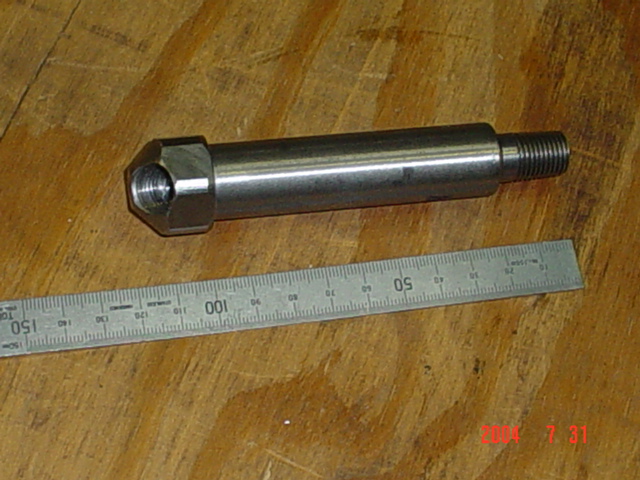

Rear drive spindles -- CV shaft to Corvette wheel hub.
Billet 4140 and heat treated /ubbthreads/images/graemlins/cool.gif

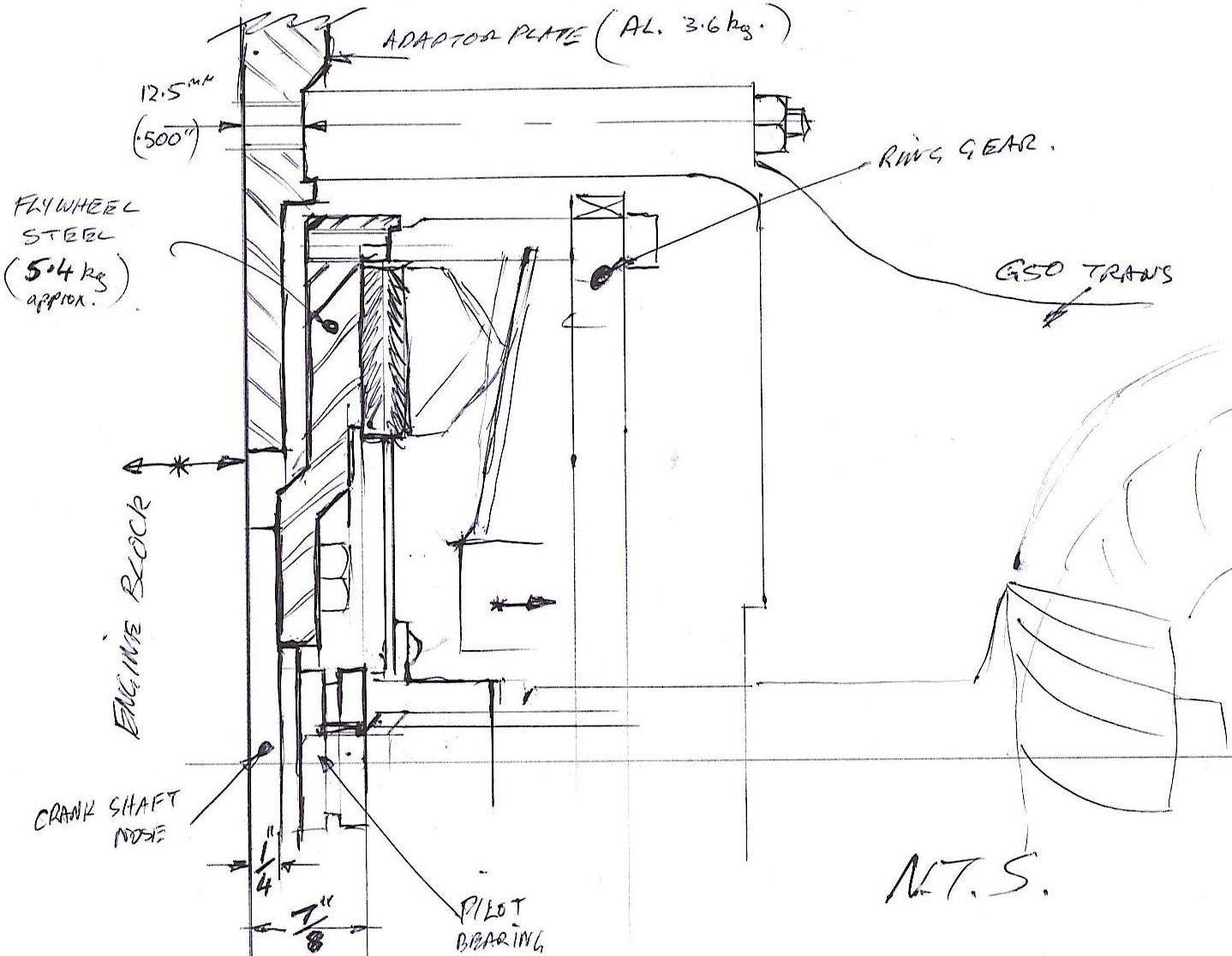

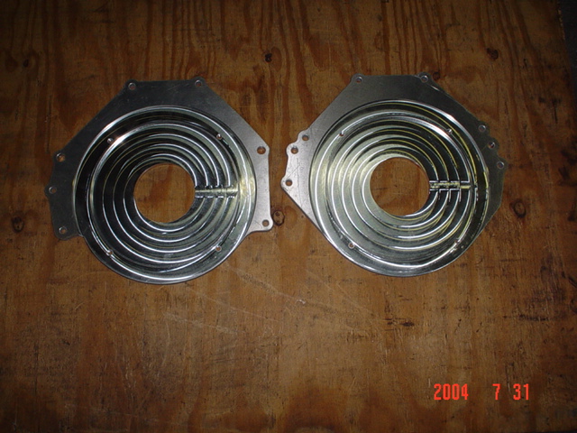

Adapter plate ( to G50 trans.)
Left is for the Mod. motor--Right is for the Windsor

Tim Kay
Flatchat,

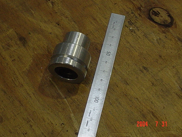

It's possible that I can use the flywheel and pilot bearing. (my first experience with 351/G50 so bear with me) I already have an adapter plate. Will your flywheel and pilot bushing work with my 12.5mm (.500") adapter plate or is this a package that should not be seperated?
Is the flywheel aluminum, what is the weight? Is it designed to have a porsche clutch wherein the ring gear is a part of the clutch assembly?
Can you explain the pilot bearing. I assume the narrow end slides into the crank up to the shoulder which leaves an extention of approx 25mm of the wide portion towards the input shaft of the transaxle. Thus the input shaft then slides into an internal bearing within the wide portion of the pilot bearing? /ubbthreads/images/graemlins/confused.gif
My concern is that my G50/52 bellhousing was reduced by one inch as well as the input shaft and then clearanced on the inside for a standard porsche flywheel. Shouldn't have a problem but I need to double check.
How much $?
