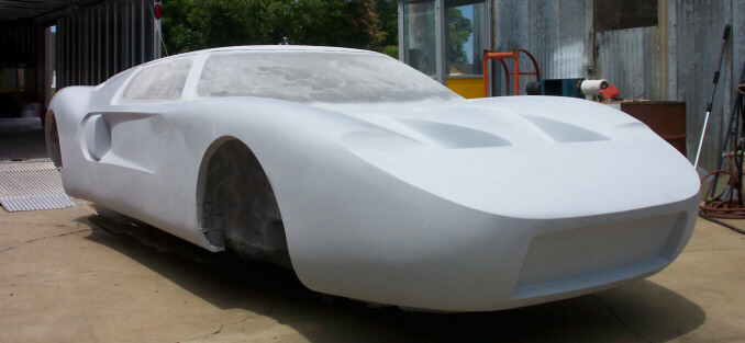

Pictures of the Giant
got it out of the body shop will do the dams next

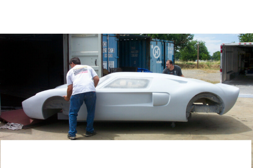

Re: pitchers of the gaint
going into the booth

Bill,
That profile of that plug is sweet lookin'! [img]/ubbthreads/images/graemlins/cool.gif[/img]

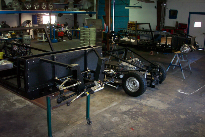

Thanks we still have a long way to go. We do have the chasses close to ready, engines and Trans are ready

Hey Bill,
Are you using an OEM windshield or is it going to be a custom made piece?
Hershal Byrd is offline

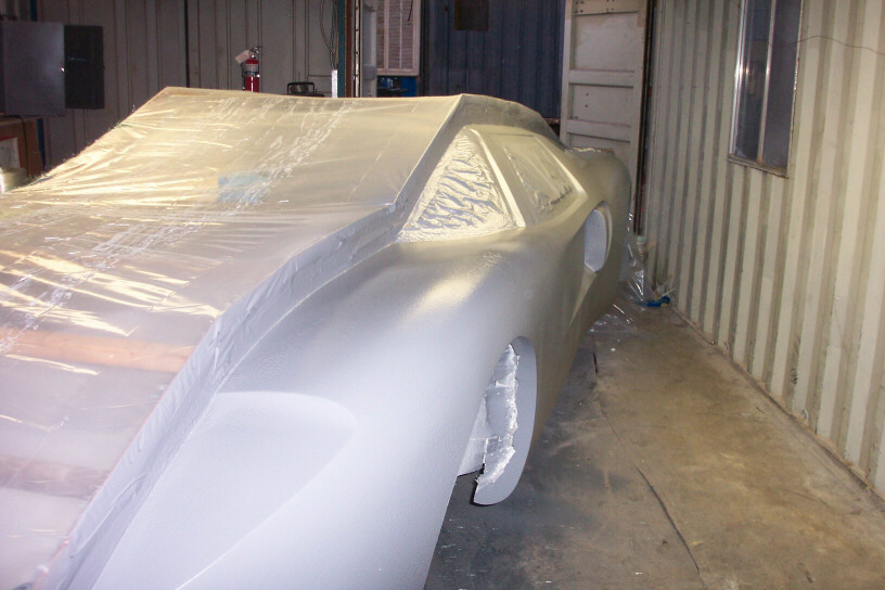

It had to be a custom glass The first one is real spindy. But not as bad as it used to be, and I got a deal from the OEM guys, Same shape just bigger. Bill we have 780 Hr in this buck and it is just the primary to make the final plug. I just finished the buffing now 6 coats of carnauba wax then the dams then PVA then gelcoat

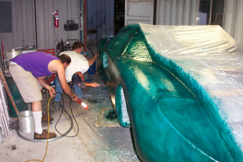

Re: Pictures of the Giant
Dam try agen
Work has slowed on the giant it was 117 in the booth whit the ac ruing on full . so we went to a night shift. At that tempter you put 16 oz of vinelester in the can and five drops of peroxide. mix wet out a one foot square of 3 oz mat then start the next Pease and the brush will not go in the can. That's just to HOT
