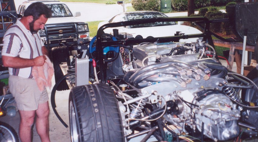

both built in the same garage

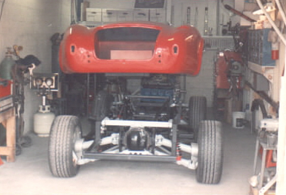

I built a cobra from scratch, had the body hung on the ceiling with cables going to a boat winch in the corner. That garage seemed fine to me at the time because previous to that I was outside.
The first thing you need to do though is paint it white and put in some lighting.

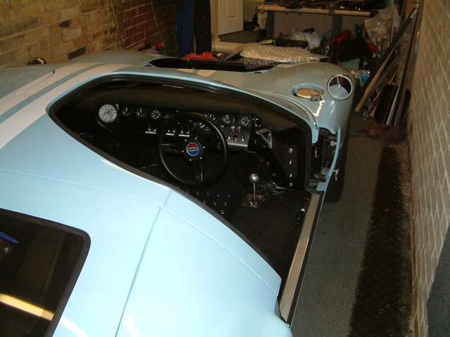

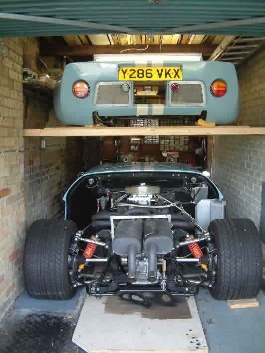

Yes, it can be done. See picture below. My garage is 7'3 and a massive 7'9 at its widest point!. OK its longer than normal but the width is the major problem.
It won't be easy but the advantages are: cheap to heat in winter, makes you stay tidy (a friend has a 16' x 20' and doesn't appear to have more room!), you can get purchase by pushing of the walls (good for some jobs).
Paint the walls white to maximise space feeling and make brighter. If you have the height add shelving above and leave room to hoist body sections. The one big advantge of the 40 over, say a typical cobra, is that the front & rear clips and doors can be removed, and the rear bulkhead panel - giving you excellent access to everything.
In essence a single garage is not your main obstacle, only determination.

Chris Kouba
Dave- Good God that looks tight! Can you get in and out of the car or do you push/winch it into the garage after climbing out? It looks impossible to get a door open wide enough to get out.

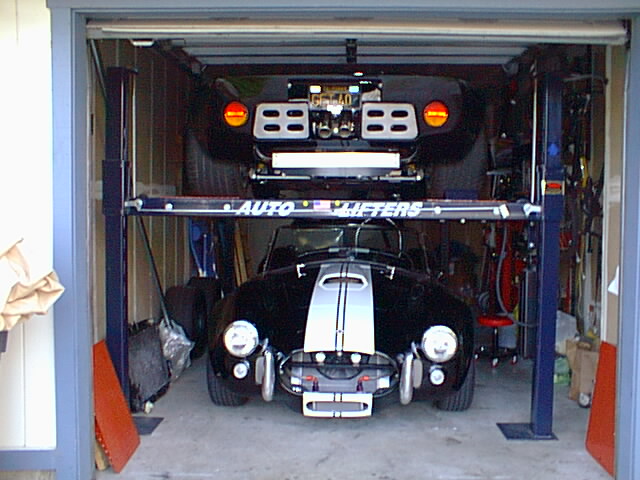

Chris
Chris, If you can afford it, think about getting an Auto lift. It is one of best investments I made. Autolifters (The one in the photo) are no longer in business, But there are lots of others you can go with.
Dave, after looking at your garage, it is clear to me now that my garage is huge /ubbthreads/images/graemlins/grin.gif

Chris, it looks impossibly narrow to me but doesn't seem too bad in reality. Now 10' x 18' that's pure luxury, I'd have sold the wife to slave traders for less than that /ubbthreads/images/graemlins/grin.gif
I can open the door onto the carpet tile stuck to the wall (and often remove it as it only takes 2 minutes) but as Paul says damaging paintwork is always a danger in a small space.
I bought a winch as I thought I would be powering the car in each time (unfortunately the garage floor also slopes and its too steep for one man to push the car in) but I found I could climb over the hinge, stand on the sill and wriggle in through the roof.
Picture with door removed (taken this morning).

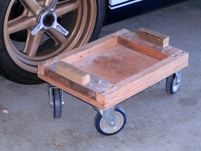

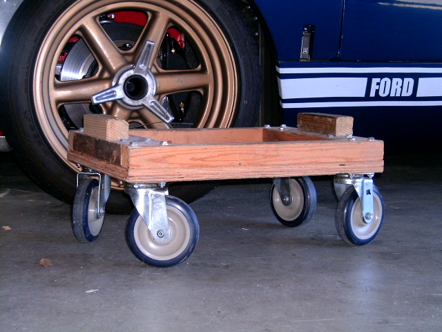

Howard Jones
The height is 7 inchs. 4" wheels, 1 inch wheel mount, and 2 inchs of wood. This takes the cars far enought off the ground to slide underneath. I can drain oil, remove seat mounting bolts, Etc. without putting on jack stands and if I don't finish I just roll it back to it's spot.
I had my car on these for the better part of 5 years during my build. It is just at the right height for just about everything. I even take the motor/gearbox out from on top of these. Just lift up the motor and roll the car out from underneath.
