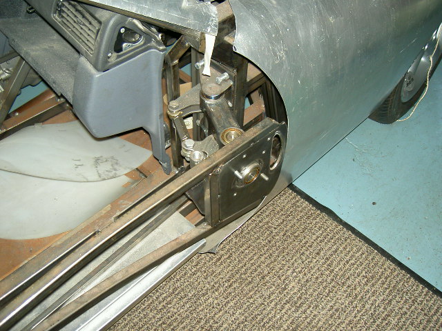

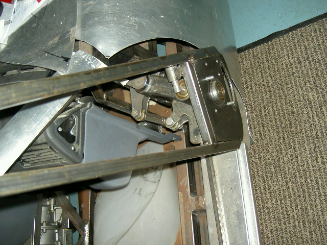

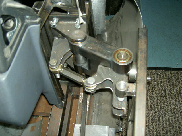

Posts: 50
Re: OK, You guys fess up..I want to know...

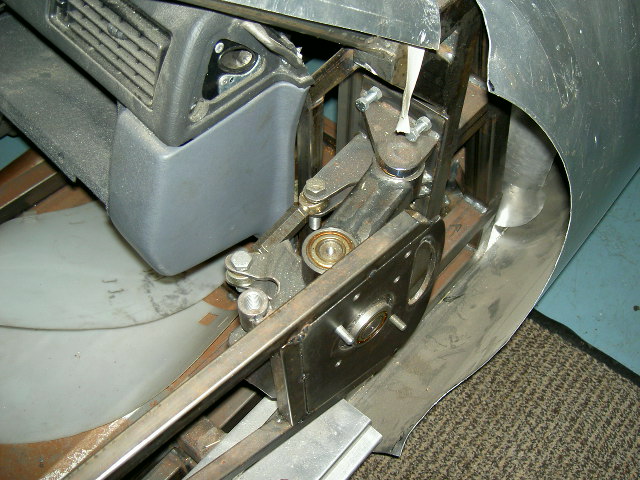

Nr 8!
Hope you enjoyed some techical ideas from the world of engineering! The Koenigsegg dorrhinge has possibilitys to adjust the gears as an ring and pinjon to eliminate backlash or perhaps some other word. You have to excuse bad english but it is better than swedish.
Best reg!
Goran
Goran
goran is offline
Old 10-08-05, 12:09 PM   #25 (permalink)
Hershal Byrd
Location: Phoenix
GT40: RF
Posts: 1,262
Goran,
That is outstanding engineering. Those hinges are better than the others I was looking at. Do you think your hinges would fit a GT40 door? It does appear that they would with a little work.

Old 10-09-05, 03:27 AM   #26 (permalink)
Sweden
Join Date: Jan 2004
GT40: Sweden
Posts: 50
Hersh! The Solon dorr hinge would fit a 40 and I have all drawings and fixtures to build them so if you are interested that can be arrenged laiter on. The koenigsegg is much more complexed because the door starts moving upward soon as the door opens and it is extreamly important that the "ring and pinjon" is set with minimum backslash so the door closes in the latch when someone fast close the door. I must say that the doorhinge really works well and if you look at a Koenigsegg´s dorr and body when it is opening and closes the shape is corvatured to allow this. I also have the drawings and tooling to build them and if there is intrest we can produce some but it is a lot of work building them correct so they will be expensive.
Well Koenigsegg is a nice car but I do prefer big pushrods engines and I had an discussion with a guy i know comparing "modern" sportscars and nothing has happend in 40 years if you consider speed, weight and power. Just throw in a mild roller in a 540 in a homebuilt chassie and you will blow the doors of a Ferrari. Mr Shelby was right 40 years ago, Nothing Beat Cubic Inches. A big bonus for us guys that likes 40 is that the car is cheap to maintain and you dont need a 10.000USD service per year and it looks great. If you compare todays carbone fiber technic with sheet metal it is much easyer and everyone can do that in the basement just by reading on internet and fixing a vacumpump and off you go.
Goran

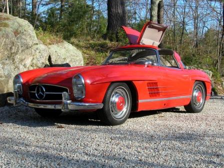

[ QUOTE ]
Just a lateral thought...If you were really adventurous, you could take this design one step further and incorporate a roof hinge system that allows the roof section to be detached from the main door, leaving the car with a targa roof type opening (for sunny days) that would not be dissimilar to the open top GT40.
[/ QUOTE ]
Here is yet another idea. The photo is of a Mercedes 300SL roadster with a custom "gull wing" hardtop. Instead of the doors opening gull-wing fashion as in the coupe, the hardtop has been fiddled to flip open to afford easier access to the cockpit.
Cobraownr is offline

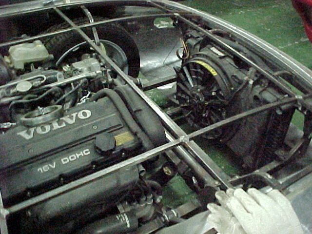

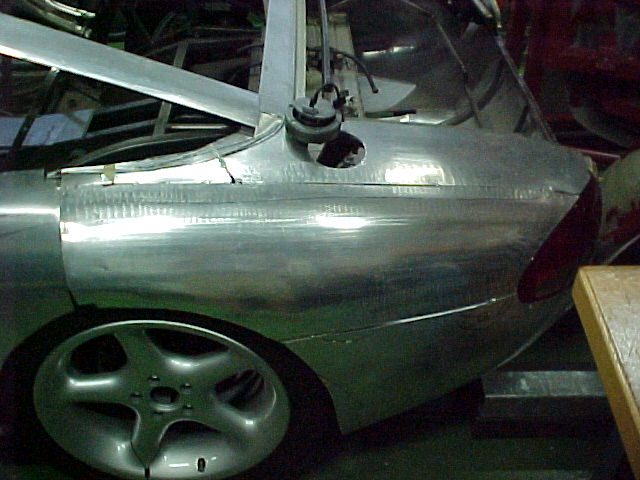

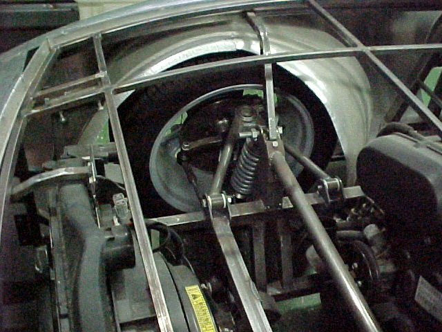

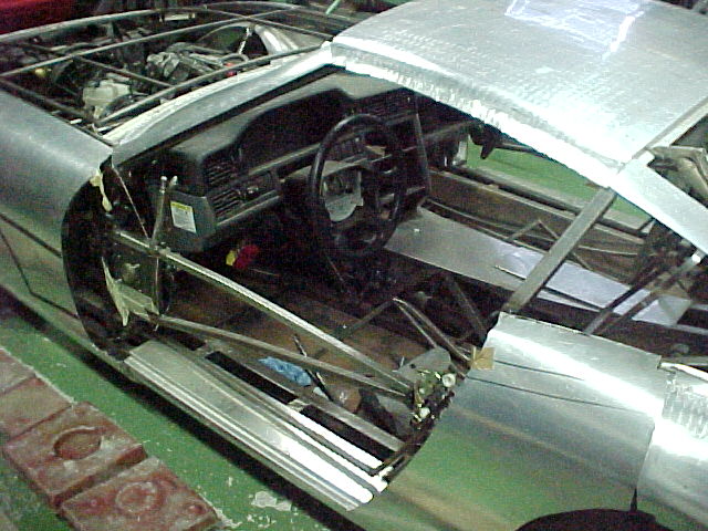

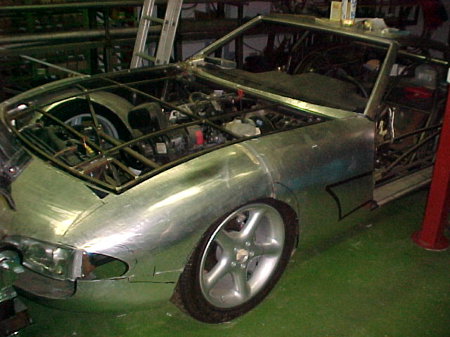

Old 10-12-05, 03:55 AM   #32 (permalink)
Sweden
Join Date: Jan 2004
GT40: Sweden
Posts: 50
Rich and all others! The carproject is an owndesign that I will finish after the monocoque project is finished. The project has a 2 liter ital-turbo B204 GT/ FT that is boosted up 4 cylinder multilink rear axel and a M46 turbo gearbox with overdrive from Volvo except my own front spindels and A arms. The idea with this projects where to build a concept from scratch and it is rolling chassie. I post some pic of the project and I´m sorry to put it here since it has nothing to do with GT 40 but it is an interesting line. The body is just rough shaped and not finished at all. I have made the body with my Eckold and the english wheel and other machines. I have also built other aluminium bodies before ( Countach) but that we have to take someother time.
Best reg!
Goran
goran is offline
Old 10-12-05, 03:56 AM   #33 (permalink)
Sweden
Join Date: Jan 2004
GT40: Sweden
Posts: 50
Pic 2!
goran is offline

Old 10-12-05, 03:57 AM   #35 (permalink)
Sweden
Join Date: Jan 2004
GT40: Sweden
Posts: 50
Pic 4!
goran is offline

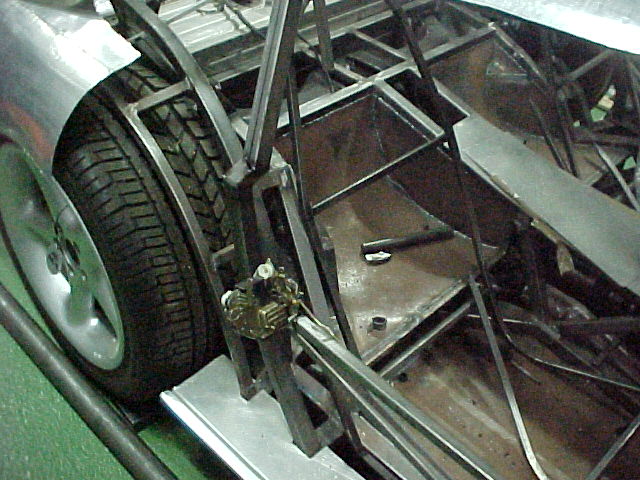

Old 10-12-05, 03:57 AM   #36 (permalink)
Sweden
Join Date: Jan 2004
GT40: Sweden
Posts: 50
Pic 5!
goran is offline
Old 10-12-05, 03:58 AM   #37 (permalink)
Sweden
Join Date: Jan 2004
GT40: Sweden
Posts: 50
Pic 6!
All for now!
Goran
goran is offline
