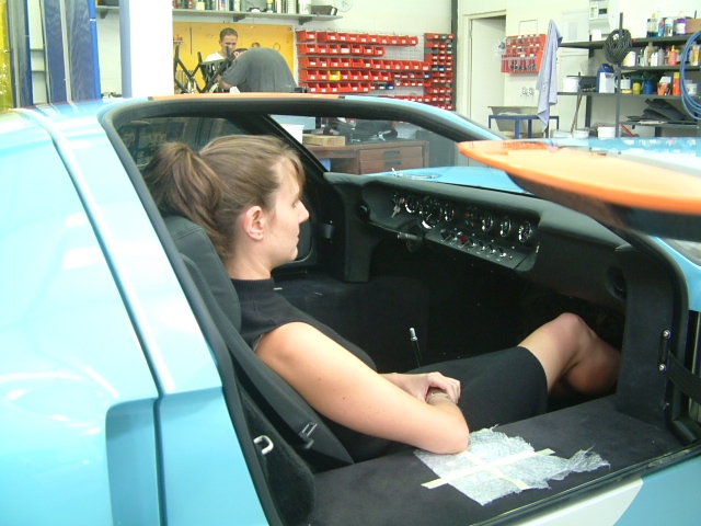

Can one get a 6\' 3\" in a GT40? ....I believe so !
Hi all GT40 lovers.Attached please find the pics proving that tall drivers will fit the new CAV GT.With a 4" ground clearance, the overall height is still 40".( see the next posting for second photo )

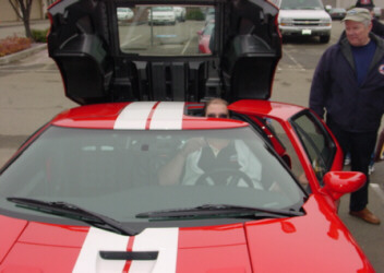

Second photo....

So, how did you do it as compared to the earlier monocoques? Or does she just have really long legs?

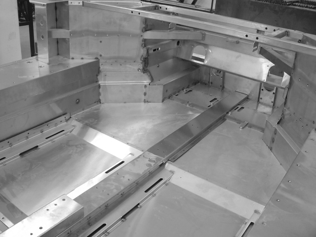

Hi Partick
We had to do two things: we lowered the seat area/floorpan with an inch and then also redesigned the seats to find another inch.The rails were removed and a sliding mechanism designed wereby we could avoid the seat being raised due to the rails. Attached photo shows the floorpan. As Roy Sales commented:" 6'5" no problem "......

I notice the picture is a of a tall girl sitting in the passenger seat.
Obviously it's more difficult on the drivers side with pedals to contend with. Can the CAV accomodate tall drivers?
I know that the new Southern GT can as I sat in it during it's development.
My home modified KVA does the job too, so its not that difficult. I'm 6'4, quite wide, and heavier than I care to admit and have no problem at all fitting in, with a helmet, and no Gurney bubble.
