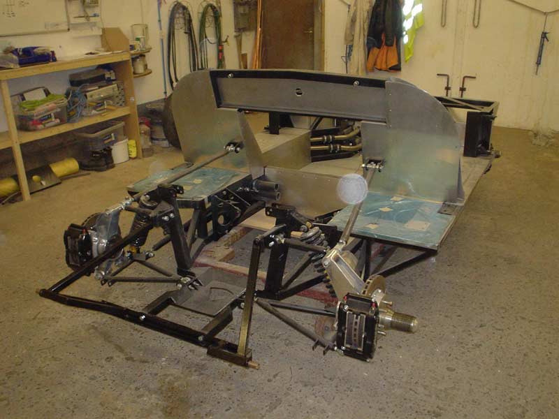

I've just bought a GTD chassis. It's fully panelled, has all the suspension, discs, calipers, shocks on it. It has Pin drives but no wheels. I'm intending to pick it up from about 100 miles away next weekend and while at the other end there is a fork lift truck to hoist it onto the trailer, when I get it home, there is nothing! I would think it's just too heavy/awkward to be lifted by hand (not sure if I could get enough bods anyway) can anyone suggest a way to get if off the trailer and onto a build trolley (which I have yet to build)

Simon, are you aware that is not a standard rear GTD chassis layout? Rear suspension looks non GTD items too. All looks like it has been modified to lower the engine.

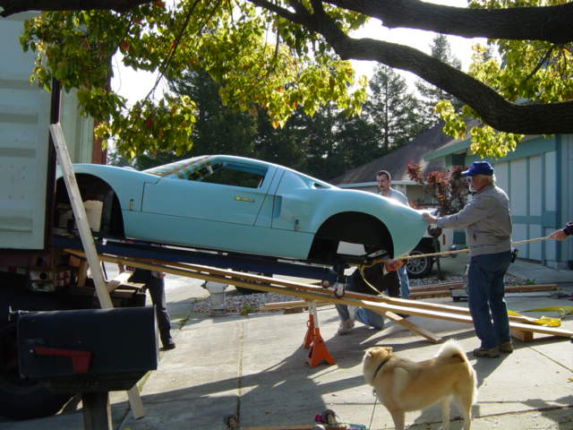

Simon, is there room on the main chassis rails for you to temporarily attach some Caster Wheels?? I unloaded my chassis from the back of a container truck (~ 5 feet above ground level) by using large "U-bolts" to go over the frame rails and thru the caster wheel plates. If this would work for you, then simply put them on before the fork lift puts the chassis on your trailer - - then take some LONG wooden ramps and you should be able to roll it out,

Hi Malcom,
Yes it's been lowered. When I was at Southern GT the other day, they said they had done it (I didn't buy it from them by the way). To my untrained eye it does look just like their rear frame.
I'm pretty sure the rest of the frame apart from the ally uprights, is all GTD (certainly looks like both my old cars).

Complete with a set of Roy Smart's Engine mounts.... [img]/ubbthreads/images/graemlins/smile.gif[/img]

Yep, and wilwoods f&r (6 and 4 pot)
