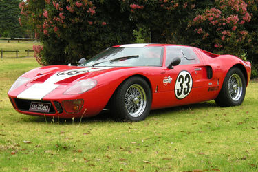

There is an auction taking place next Sunday here in Melbourne Australia. It is a complete 1989 GTD40, you can view it here:
http://www.shannons.com.au/pages/auctions/lot.jsp?id=PQC7A8EC0TAV1CHF
Sale price range is $60k to $72k AUD (43-52k US or 37-44 Euro) for a complete car.
Shipping a car to the states is about $3000 AUD, don't know what it would be for Sweden, but being conservative, you could have a complete car in Europe for under 45000 Euro.
Bill.

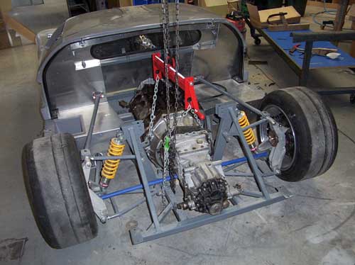

Welcome Cassius
your question which car? has been asked many times and has drawn critisizm as to why newbies don't use the search option. However searching doesn't always bring up the right answers and your enthusiasm for GT40s is highly apparent.I have been racing against Porsche and Ferrari etc for nearly 3 years now and I would recommend you take Howard's advice.For racing you need the motor and transaxle as low in the chassis as you can get it.Not all transaxles allow this while retaining sensible driveshaft angles.So which car is not really as important as which Transaxle.Forget Audi,you'll need a ZF, G50 or one thats going to be reliable with 500+ HP.A side benefit of having the motor low in the chassis is that it can go further forward, a real benefit for weight distribution F to R chassis balance.Take a look at the Pantera.Because the ZF is upside down the motor is really high in the chassis and a GT40 with lower COG will out handle it in corners.So whichever car you choose you need to select a transaxle add the motor to make it a unit and then fit it as low in the chassis as you can.
Ross /ubbthreads/images/graemlins/beerchug.gif
Ross Nicol
This is my car at the fitting motor/transaxle stage ZF on the rear of windsor 302
