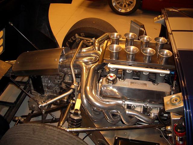

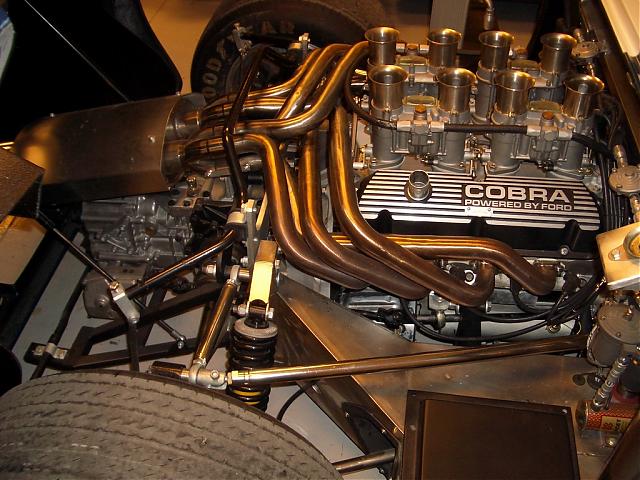

Here are pictures of one of each in a CAV build build by David Wagner in Detroit who was one of the original old CAV dealers.

The top photo is a Cleveland.

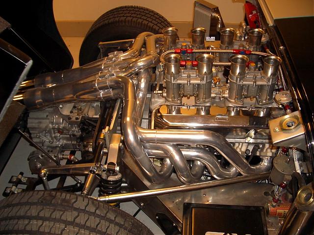

Cleveland not Windsor huh? What are the features that you noticed that indicate it is a Cleveland? I must have the two mixed up and would appreciate knowing what to look for in the future. Thanks,

Bob,
The Valve Covers.
Clevelands have 8 bolts.
Windsors have 6 bolts.

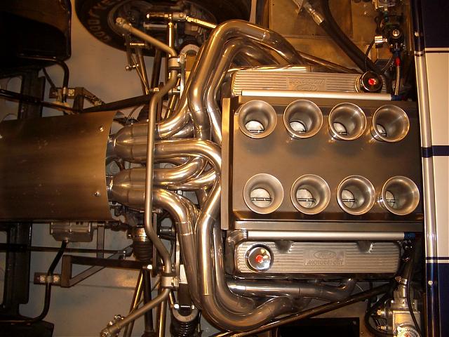

Thanks Rich, That's easy enough. 8 Cleveland, 6 Windsor.
