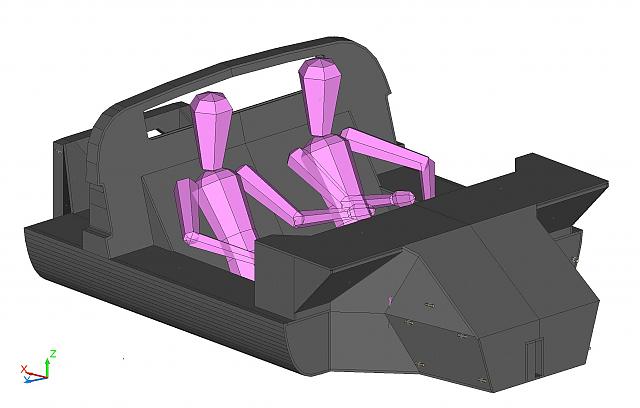

hello
what do you think about carbon monos

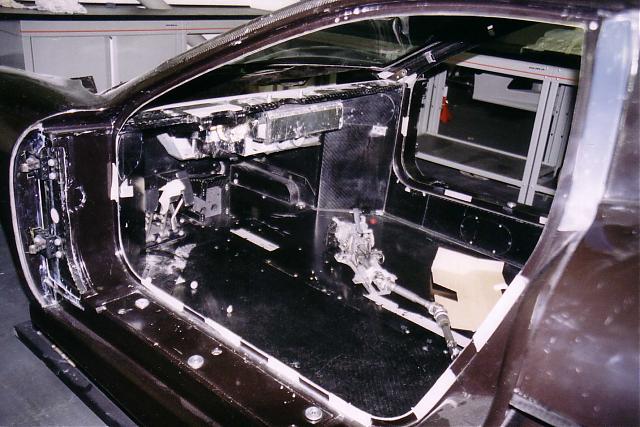

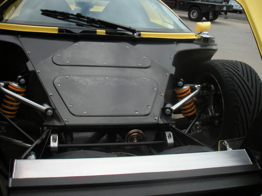

I think it i a great idea and will be light
Also the strength should last and Ascari are already making Carbon chassis for their road cars
Here's a pic of their car when the GT40 clubs visited about 2 years ago

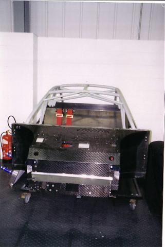

Could make a strong and lightweight structure.
If it is used the correct way and proper UV light protected it also should last.
Another good example for it is the porsche Carrera GT.
I have some great pictures of there chassis. as soon as i find out how to post here i will do it.

Looks familiar or !
What do you think ? looks close ha
@ron pictures are linked
