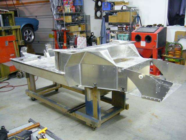

J,
I'm with Randy...totally. I made a chassis buck which I have now built three cars on. Man was it worth the time to make. I too have a hoist, which I utilize to put the chassis on and off the buck. It is much easier on the back to work all day w/o bending over.
Additionally, I made forms which secure onto it to mount the body to for prep and paint. Very handy not to have them sliding around a saw horse or the like while trying to work on them.
That's my two cents.....

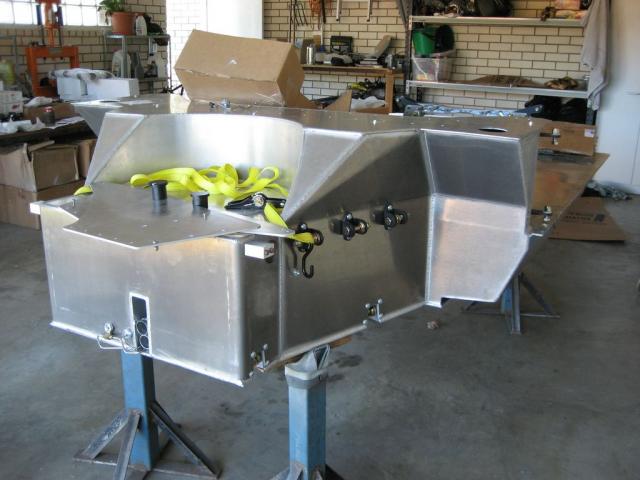

My brother is just using 4 large home made stands. They are just like oversized axle stands. They are about 2 foot high.
