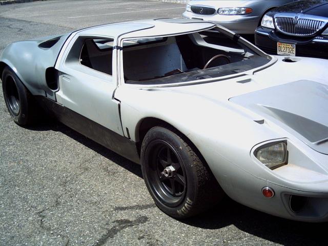

My clip measures just under 80" lip to lip, the lip is approx 1" wide and out side to outside of tire is approx 76 1/4" as good as a tire can be measured.
15" wheels X 14" wide with Avons, backspacing on the wheels is 5 7/8"
Here is a photo.

Thanks for this!
What size tires are you running?
My builder is telling me that it will be 78" wide so that fits in closely with what you are reporting too BTW.

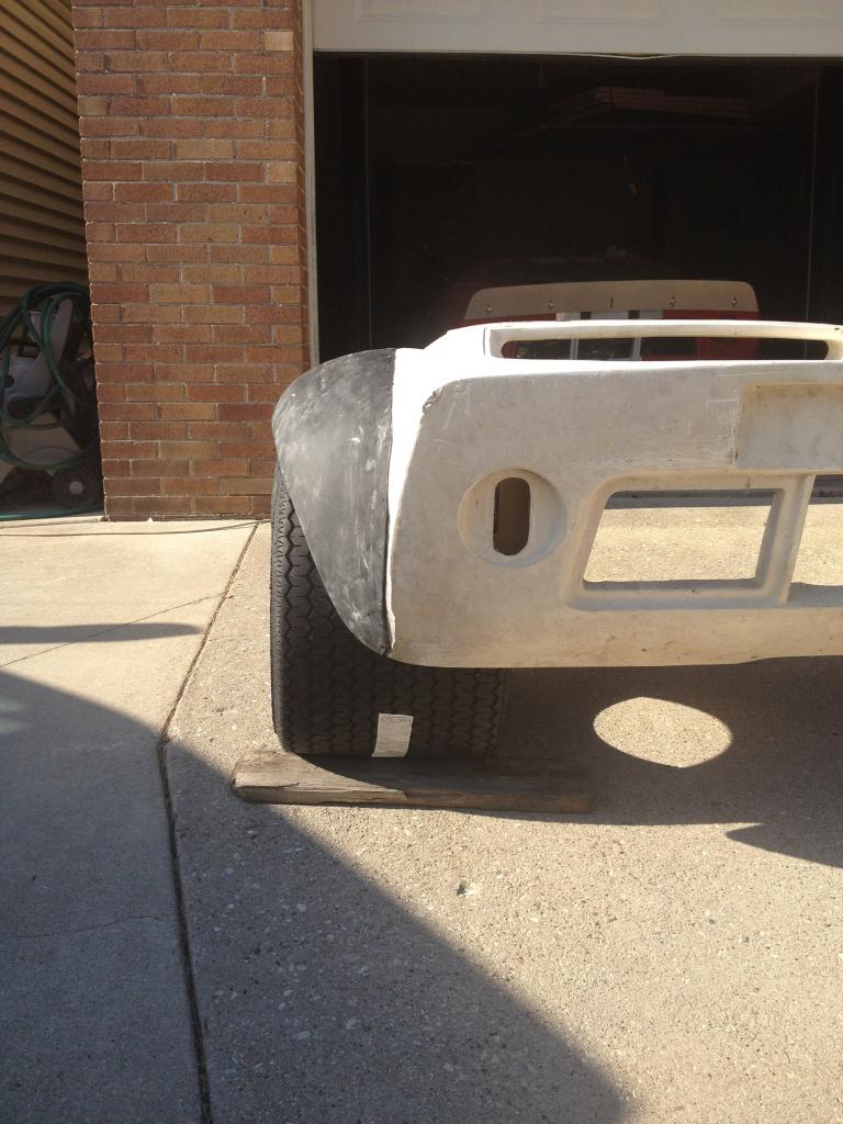

78 will be fine, I just added some gulf flares to one of my clips and it is 77.5ish no lip. I am going to run MT sportsman pros 15X15 on 14 inch wheels. I think I read somewhere that some were even wider than 80......... Post a pic when you get it, Scott

Here is a pic to give an idea of tire size/flare width......

I feel a lot better now. Was really worried that wide area wouldn't look right with only a 13" wide tire but CScott's photo looks very good to me (even though it is 2" wider than I will run assuming he was talking tread width and not section width).
