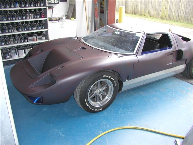

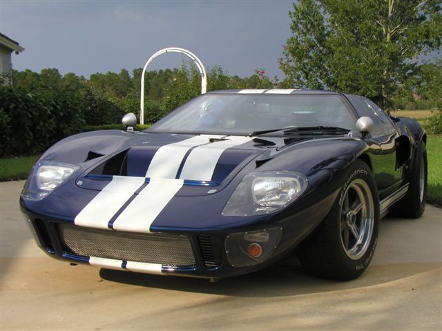

I've been frustrated with the fit and finish of my car and the obsessive compulsive side won't let go until it's perfect... This is before:

Holy cow! I'm also a bit of a perfectionist, so I'm curious. What was it about the fit and finish - can you note some details? For example, was the paint not smooth? were some of the body panels not flat? did some of the panels not align well? Do you suspect these problems existed from the beginning or were they a result of normal wear and tear?
I'm interested since I know CAV's were all 'factory built rollers' and were not inexpensive. I'm wondering what wasn't up to par for you.

As you can see on the "before" photo, the fit and finish were not awful and I'd say were a B-.
The panels rubbed away paint in places on both the front and rear sections as well as one spot on one of the doors. The rear deck was also hung 1/16th higher on the right side but you really couldn't tell without a level. The gap lines were not consistent and would vary by an eighth of an inch in places. Not bad but still not what I want.

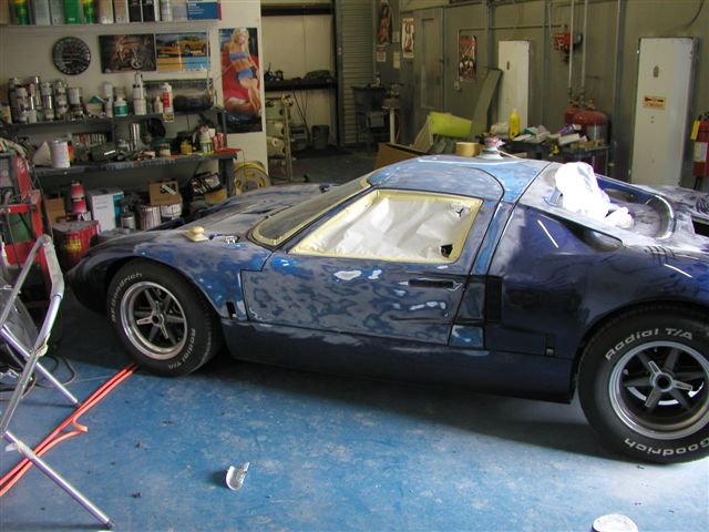

The biggest problem as I saw it was the paint finish. As you look at the "now" picture you can see the high spots are the lighter colors. The paint tech working on it indicates a couple of problems are at the root of it. First, the primer/filler was sprayed inconsistently, puddling in some places and barely covering the gel coat in others. In addition, solvent was apparently dripped on a couple of places causing blisters/bubbles in the paint. The car also seemed very susceptible to stone chips and scratches. All that said, I'm taking it from an acceptable state to something show quality. The fact that I drive the thing and do occasional track days means I suspect more body/paint work will probably be in the future.

I've always liked the color so I'm not changing that but getting it resprayed with better paint. Tracey has had the car for a little over a month and is making steady progress. He also found a couple of voids in the fiberglass which would have been a problem over time. I've taken your advice and visit him every week. When does your car get back from Michigan?

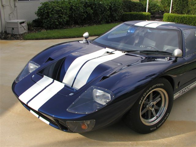

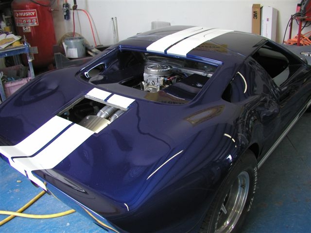

Getting closer. Tracey does spectacular work. The pictures don't due it justice.

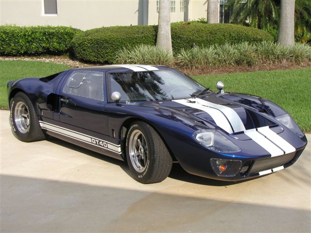

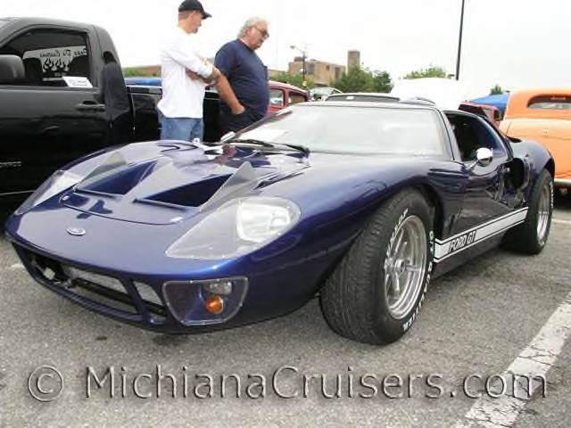

Sorry to hear that you are not happy with the finish on your car. I am very pleased with mine and I have had some very nice comments on the quality of the paint. In fact I was at a show tthe past weekend where ther were some high end street rods and was surprised to take an award over them.

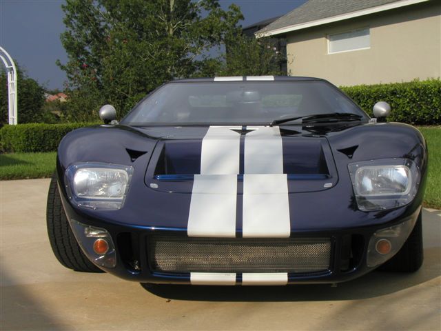

Hi Tom,
I'll post a couple and send you an e-mail with others.
