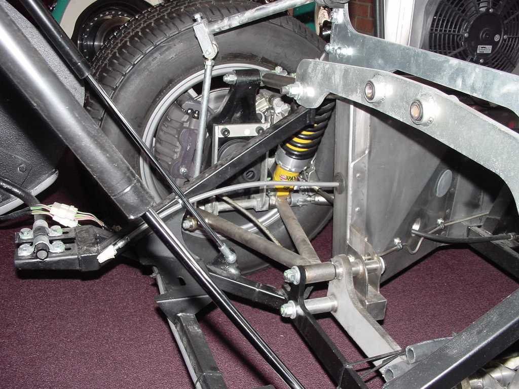

This picture shows the starting point. Fresh from shipping, this car is a little dusty but with the drive shaft removed, all the relevant early design parts can be seen. The flat steel crossmembers were previously replaced with a single stainless steel box section described in Part II. The stock lower A-arms are V shaped with rubber bushings and no cross bracing. The uprights have an external frame. The smaller trailing arms yokes can also be seen. All of these pieces will change. I will remember to not wear brown shoes and to not let the car fall.

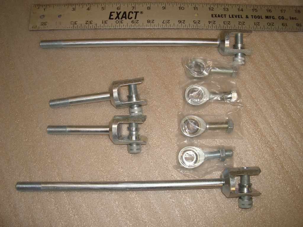

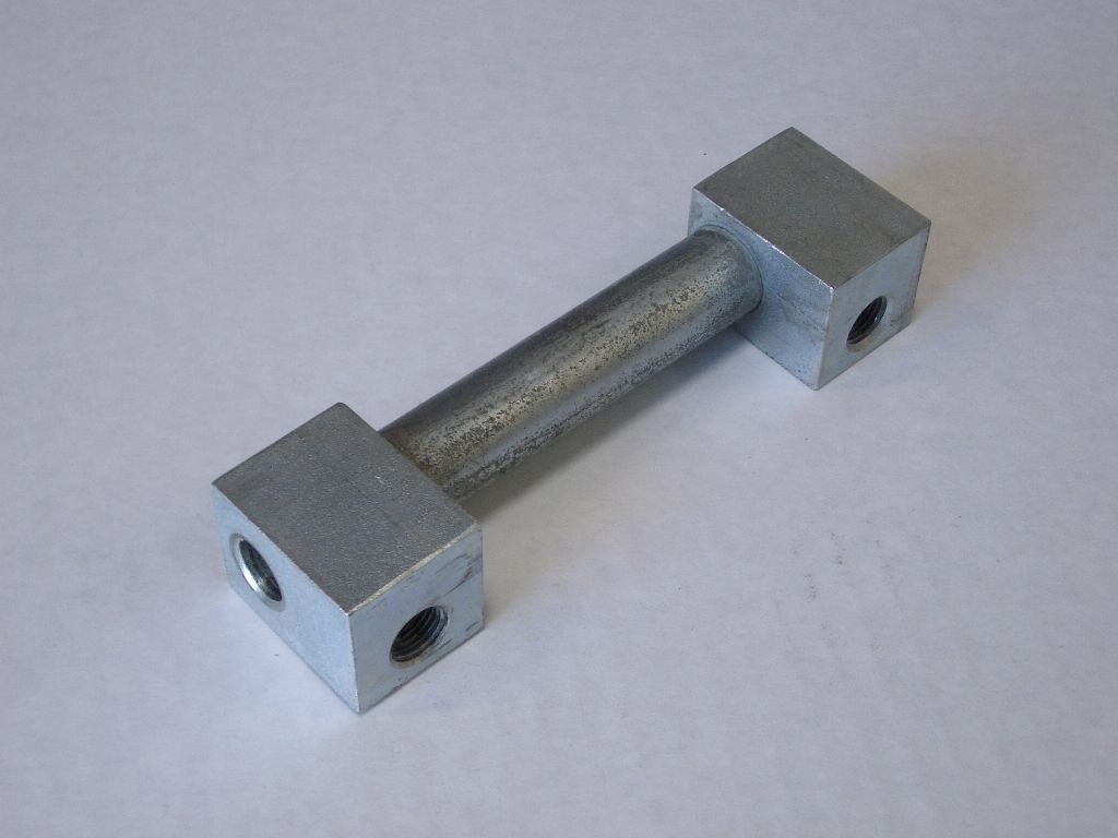

The difference in the original yokes and the new parts is clearly seen in the following picture. The new parts are much stronger. These parts are a bolt-on replacement to upgrade stock CAV rear suspension. However, they must have the connecting rods lengthened to use them with Ian’s A-arms (which is what I did). Alternatively, new yokes can be ordered directly from CAV-Canada with the correct length shafts.

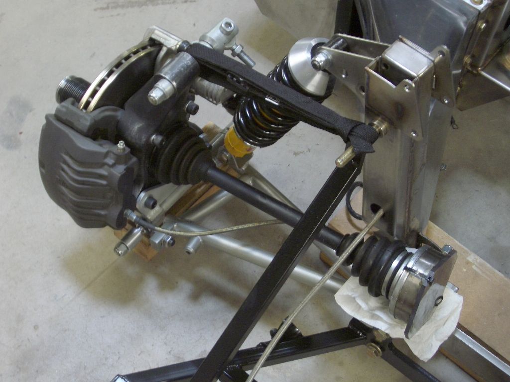

I have been working on the front upgrade. Lower A arms now with polyurethane. Uppers shown
here.

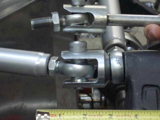

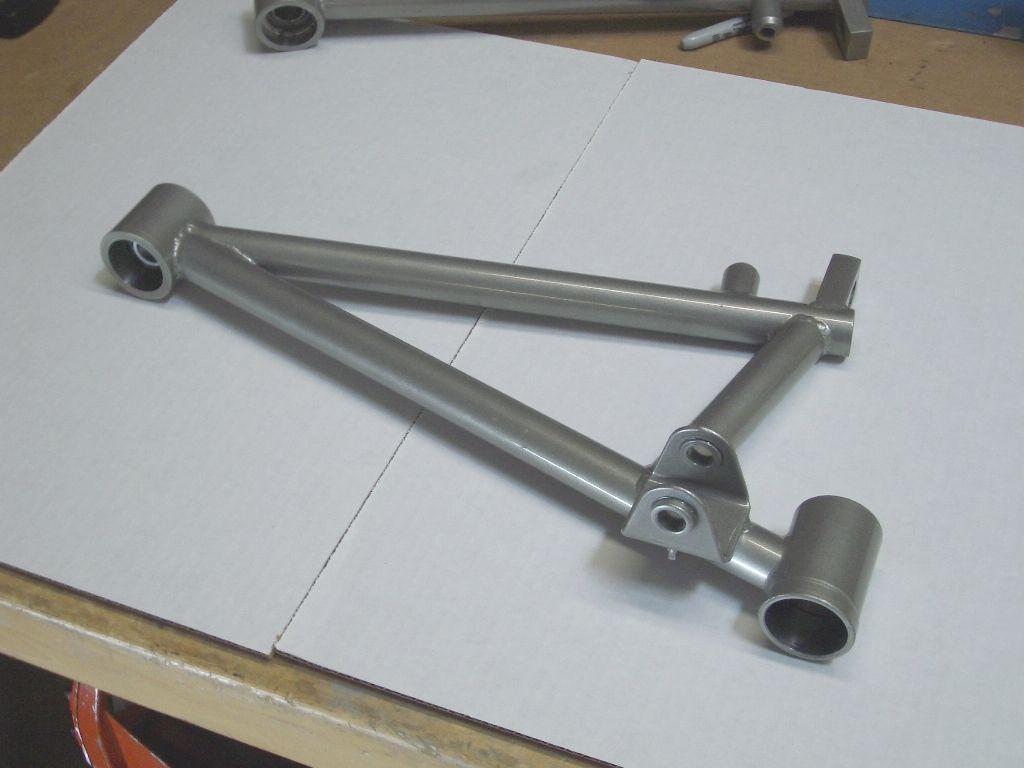

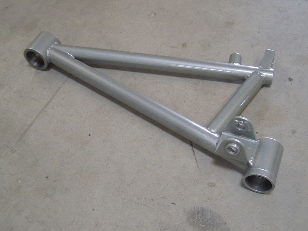

Here is the A-arm from CAV-Canada. The other attached parts will be mentioned later. Ian has already presented and discussed his design on the forum so I am not stealing any of his thunder. As far as I am concerned all of the people who have gone to the trouble of designing and manufacturing low volume specialty parts, and make them available to the rest of us, deserve appreciation and recognition.
An exposed rod end is used at the rear corner of the upright to adjust toe. The other two corners have monoballs (ball joint swivel bearings) inside the round housings to allow the arm to float.

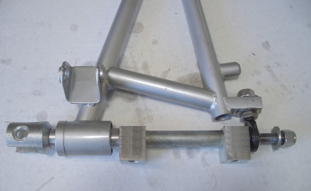

The sequence of yoke, spacer, monoball, spacer, upright bracket, and rod end makes an easy bolt-on operation.

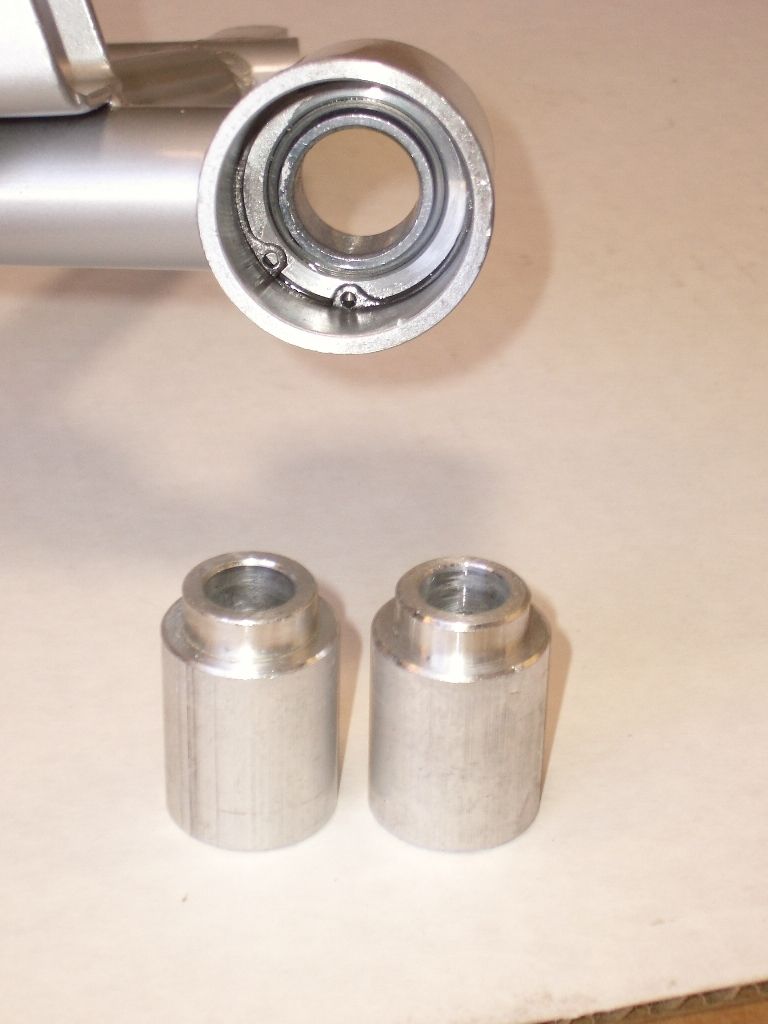

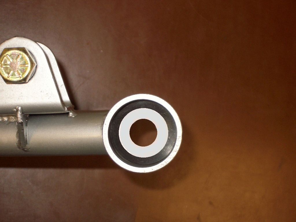

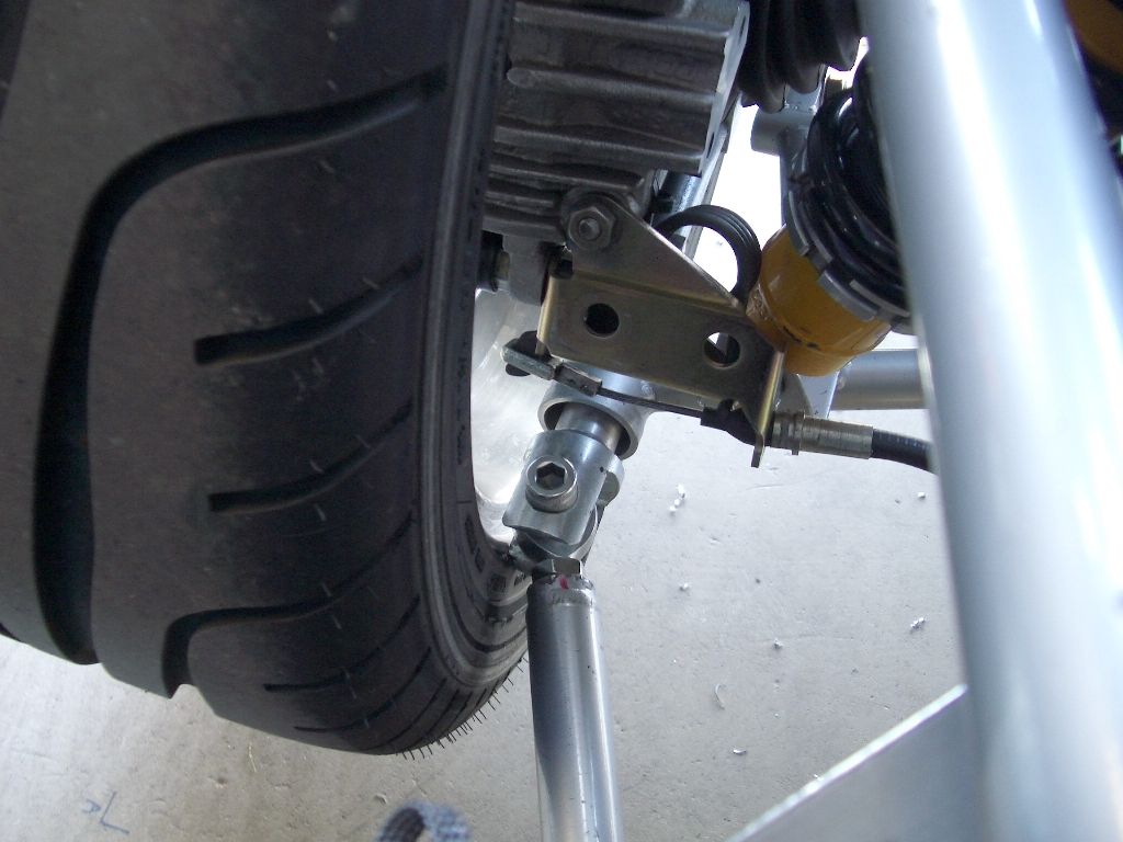

The A-arms essentially fit flush with the bottom of the car. In that position the Teflon-lined monoballs and spacers are subject to much more road grime than the rod ends at the top of the upright in the engine compartment.

To protect against road grime, I added thick neoprene washers stretched over the spacers on both sides of all the monoballs to totally seal the area but still allow flex and movements. I know some of you will protest that this doesn’t feel natural but that is the price of protection. Side seals have also been added to the rod ends on the lower trailing arms.

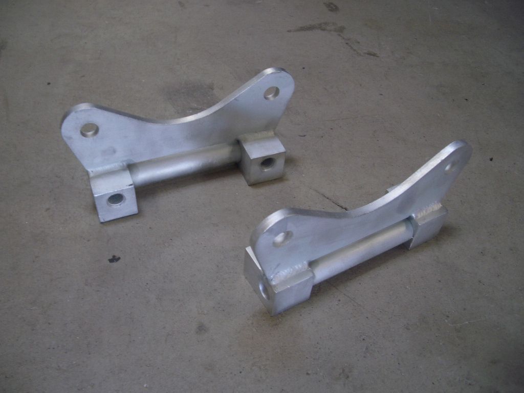

By comparison you can see that the shock bracket has been moved so the line of force is through the attachment point and directly over the strut. The relocation also accomplished two other benefits for my car. First, moving the bracket slightly to the rear eliminated crowding between the shock absorber and the emergency brake. Second, moving the bracket out to the end of the A-arm better positioned the stroke of the shock absorber into the center of its working range (more on this later).

In original CAV configuration, the lower A-arms attaches to the upright via an external rectangular shaped steel frame as shown in the first picture at the start of this post. Ian recommended removing the upper part of the steel frame to leave just the lower end when using his A-arms (see following picture). The rationale is that since the new A-arms incorporate a rod end for toe adjustment, there is no need to use shims. Therefore there is no need for the top half of the steel frame since the bottom is now always bolted on flush and flat.

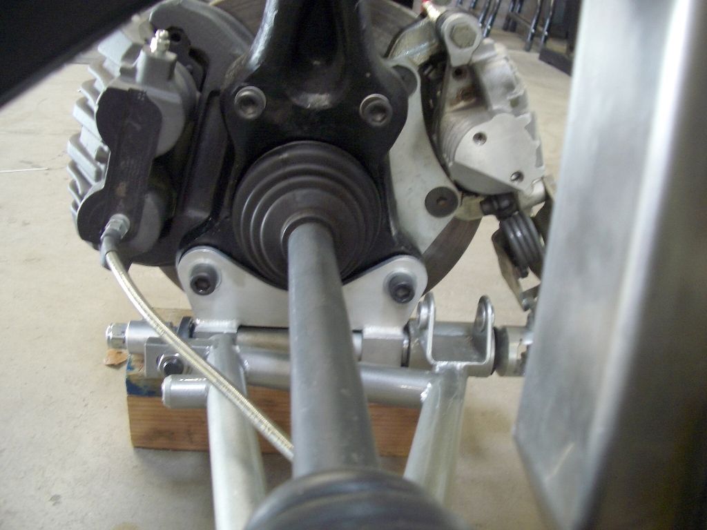

As luck would have it, the same designer that made the motor mounts and crossmember had also independently eliminated the upper frame but replaced the structure with a simple flange. Here the flanges have been welded on and the parts silver chromate plated.

The new flange piece wraps half way up around the drive shaft. The modified assembly attach with 4 bolts, instead of 2, to spread the force from the A-arms evenly over the entire lower half of the upright. I think it is a perfect companion piece to use with the parts from CAV-Canada. I always hedge my bets.

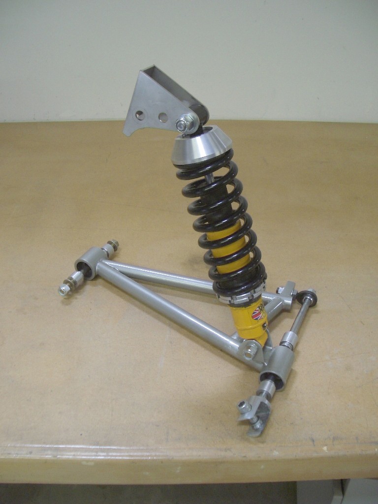

This picture is a different view of the A-arm assembly with the shock absorber just set in place. The upper shock mount is still loose and not attached to the chassis. All the rest of the suspension pieces, including the trailing arms and wheels were then attached and checked for correct fit and clearance.
