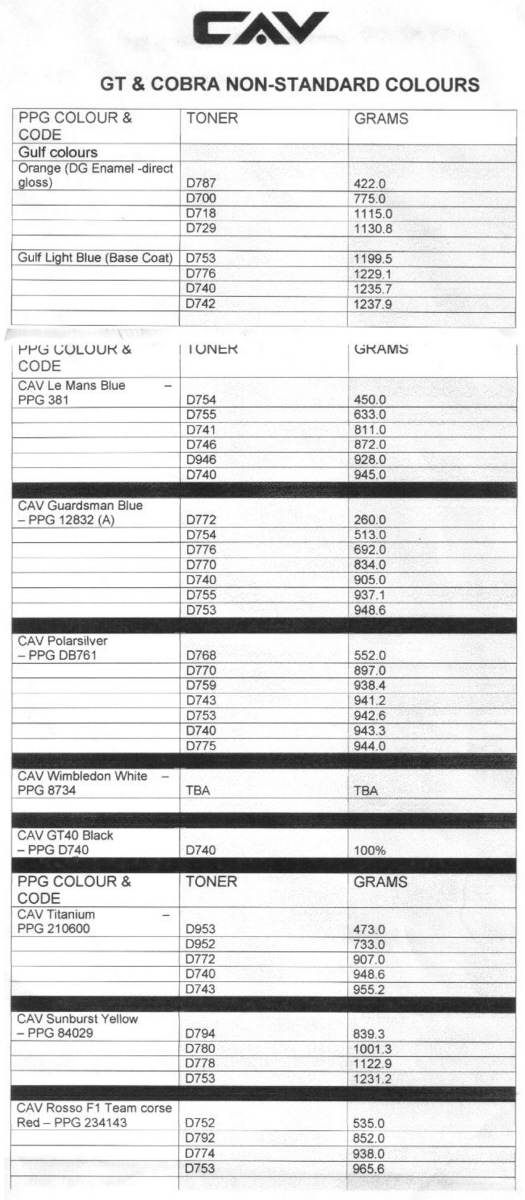

CAV Paint Codes
Here's the list guys, original PPG tint bases and weights. Remember though, if you're touching up a damaged area rather than a complete respray, have you PPG rep come over and scan your car. They can work from that or the codes. Chances are the scanned software will come up with different numbers. Even if you had some factory paint to spare, it could look off now due to many factors in painting a car.
