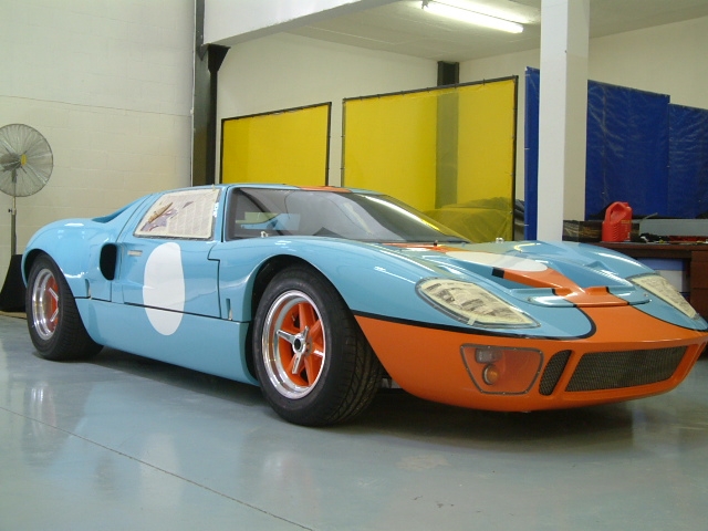

• The Gulf car earmarked for the Congo is nearing completion. See attached photo.

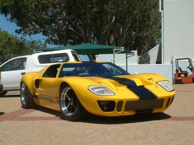

Our own demonstrator is also coming together nicely. It has a 450 HP street racer engine with a new fuel injection system which we will be testing, coupled to the RBT 5 speed transaxle. The imported 17” BRM’s look incredible and work well with the aggressive colour scheme of the body. Please see attached photo. All things being equal, this car will be featured in a movie to be made in Cape Town later this year.

And the demonstrator.....

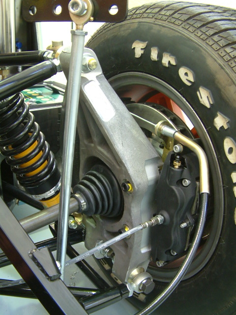

...and a photo of the new CAV GT rear upright!
