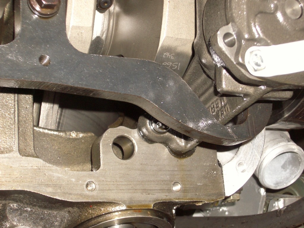

The problem I encountered is already known to some members of the forum. Like I said, the GT40 is a demanding mistress and if you expect her to wear a girdle you have to be firm and insistent.

Here's one for you... does the Armando pan clear the girdle? I have an Aviad pan and you're one nightmare ahead me on this
Also does your pan come with the pickup (oil not the truck!)?
We've sectioned and baffled Canton pans in the past and worked great so there's lot's of ways to skin a cat LOL

A steel girdle is cheap insurance despite its additional weight. Bolted to the main bearing caps it significantly increases the rigidity of the lower end and is something appreciated by demanding mistresses of all types. The problem is that the stock Armando Oil pan does not have enough inside clearance to fit over a 7 inch wide girdle on the main bearing caps. The main area of interference was the concave starter motor intent. The Canton pan by comparison has straight sides, and modern starter motors apparently have smaller diameters that fit just fine with plenty of clearance without a starter indent.

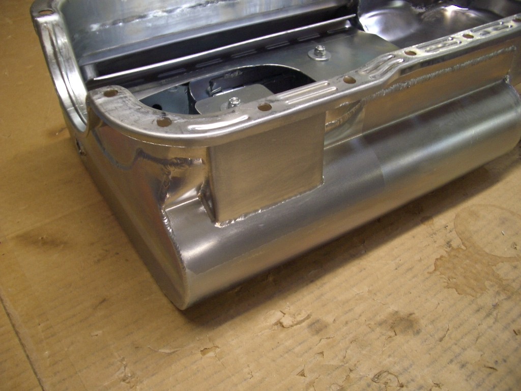

I have to say that Armando is a stand up guy and he did exactly what he promised in his advertisements to get the oil pan to fit. I sent him pictures and measurements and a few weeks later a revised oil pan arrived with the concave starter indent left out. Except for the indent being removed, this is a standard full-size full-length GT40 oil pan and the end of the pan now looks just like the Canton. The oil pan also included the correct height oil pick up tube with screen (in picture #1) and the oil dip stick tube with fittings.
Theoretically with the starter indent gone, I could now do a trial fitting and actually mount the pan to the engine block. Theoretically that is…...because now that the starter indent was gone I discovered that the girdle around the bulge of the oil pump was also lacking sufficient clearance. This picture shows the girdle as it goes around the oil pump which used to clear the straight sides of the Canton Oil pan.

One problem with armondo's I just discovered is that if you have a 4 bolt mains,the pan will hit the out side main bolts. It had to be re-fabbed to fit the 4 bolt main..Just a note of thought.
Oliver

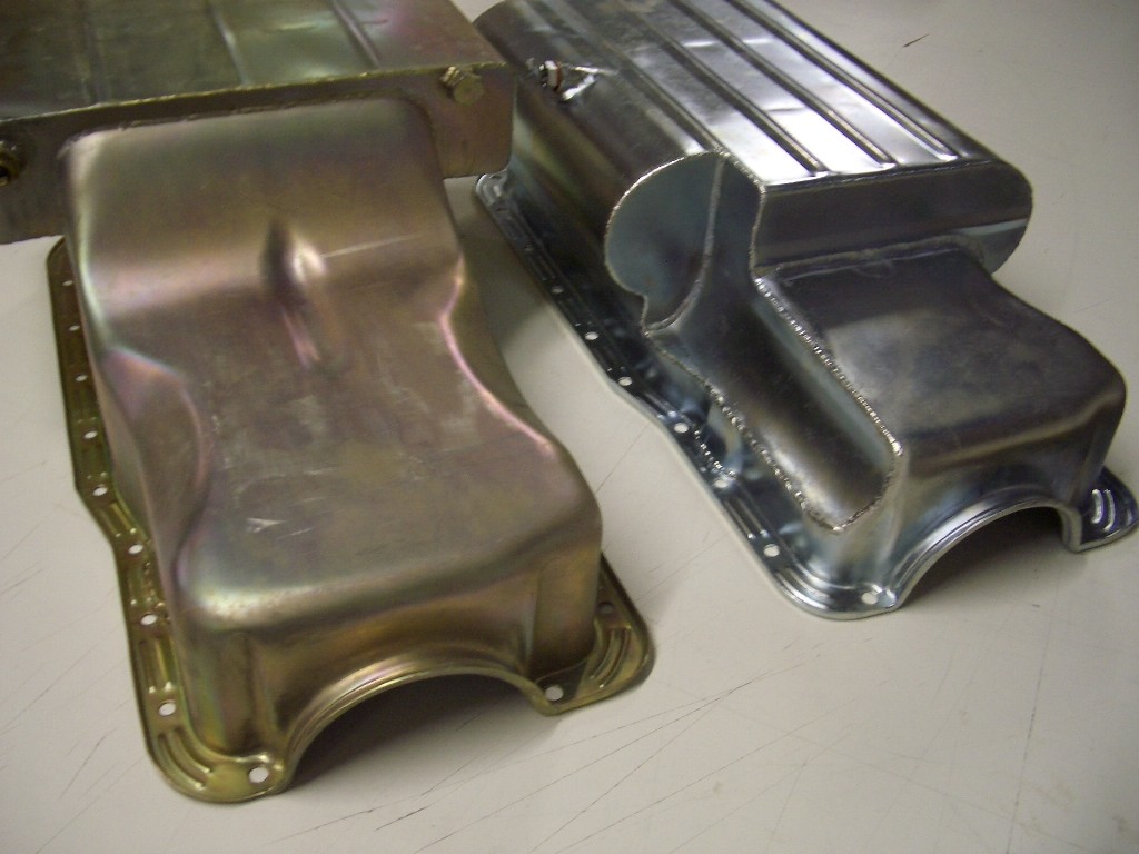

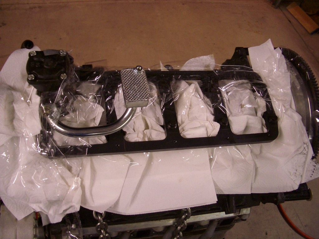

And this second picture shows the area of interference inside the oil pan. The oil pump clearance problem is probably an artifact of the welding around the circumference of the Armando pan and may not be present in the variations from pan to pan.

This clearance problem was not as extensive as the starter problem so I decided to fix it myself. Like I said, the interference was small and it could have probably been hammered out. However I wanted a total no problems fit and decided that it would be better if a cap was made to fit over the entire interference area and then welded in place.
Oliver
[/ QUOTE ]
On my engine Keith Craft just did a little modification with a hammer and it fits fine now.

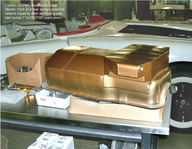

Hi Bob,
Here's a pic of the Canton pan sectioned 1", starter recess inceased, twin sumps joined to restore capacity.

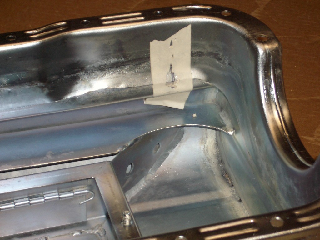

After the outside cap was welded in place, the inside interference area was cut away and the edges were smoothed. There is still plenty of clearance around the starter motor and I have the added strength of a girdle on the main bearing caps. If you want an Armando pan done this way, I am sure he would be happy to accommodate.

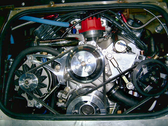

Moving the engine forward was more involved. The main obstacle was the MSD billet distributor. Even with the motor now 1 1/2 inches lower than before, the large diameter distributor cap remained within 1/2 inch of the rear window frame.

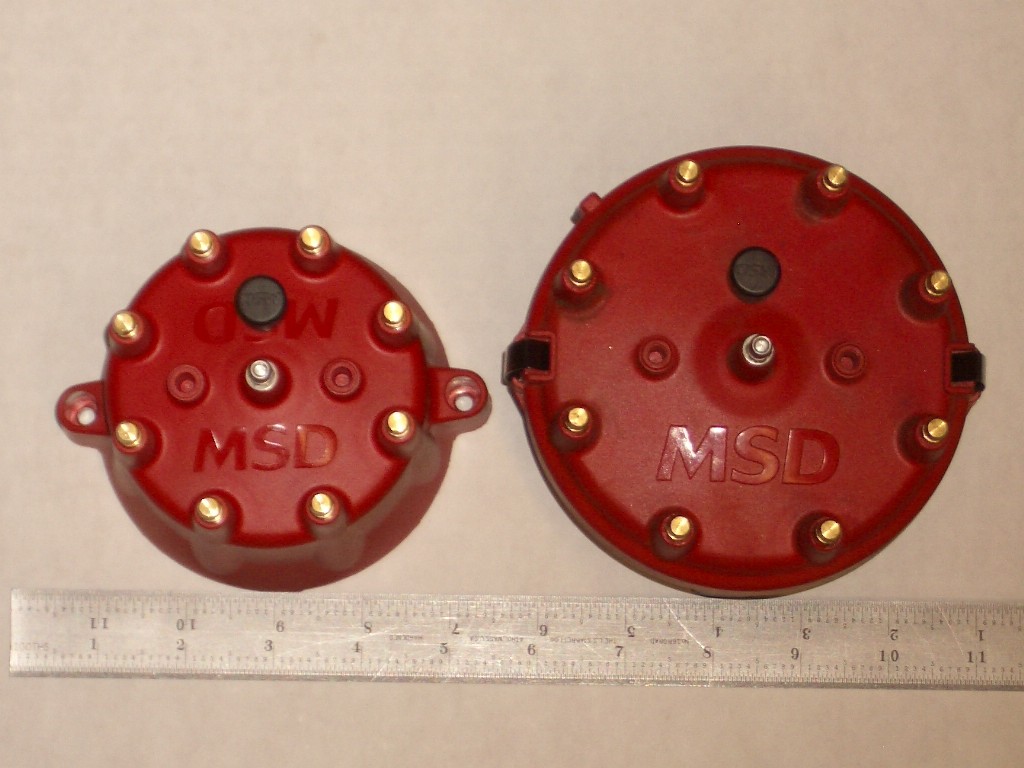

Wow Bob. It's like Deja vu. If you have not finished the job yet you could try the smaller diameter MSD billet distributor. You can get a glimpse of it is some of the shots on THIS PAGE. Much smaller in diameter. I think it is MSD 8578.
CCX33911 is offline

Yea Gary, you already pointed this out to me and I did not forget. Much of what I do here is really based on helpful advise from you, Ian, and others. Here is the next installment:
I guess a lot of forum members already know that a small diameter distributor needs to be used on a GT40 but again I must thank Gary Gibbs for telling me a few months back because I did not know. (Just like I did not know that the GT40 oil pan is virtually mandatory if you want your engine to sit low in the chassis.) And for that matter almost everything I do has been done by many others, but is mostly shown as a result, not as a small step sequence.
After doing a bit of research I was able to simply replace my large diameter Ford style MSD distributor cap and rotor assembly with smaller GM style units from MSD. As you can see from the picture, the GM style unit has a diameter about 1 1/4 inches smaller. For just a bolt-on fix, I thought this was a huge improvement. If I wanted to replace the entire distributor, even smaller versions are available like the one previously shown in the attachment called “MSD small dist.bmp.”

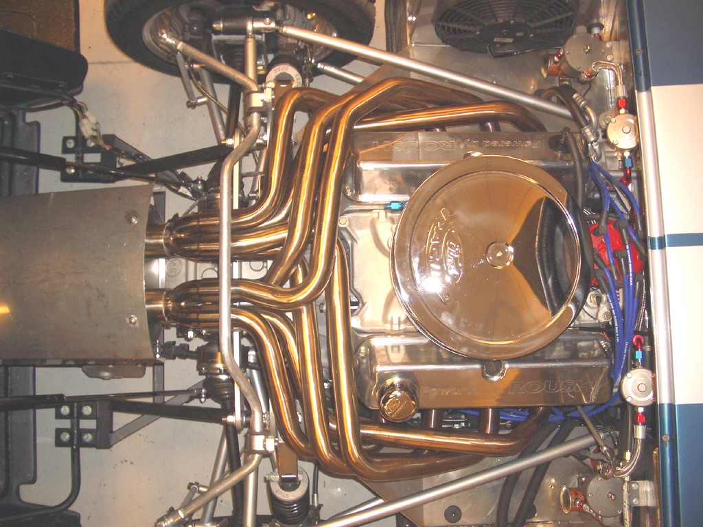

Hi Bob,

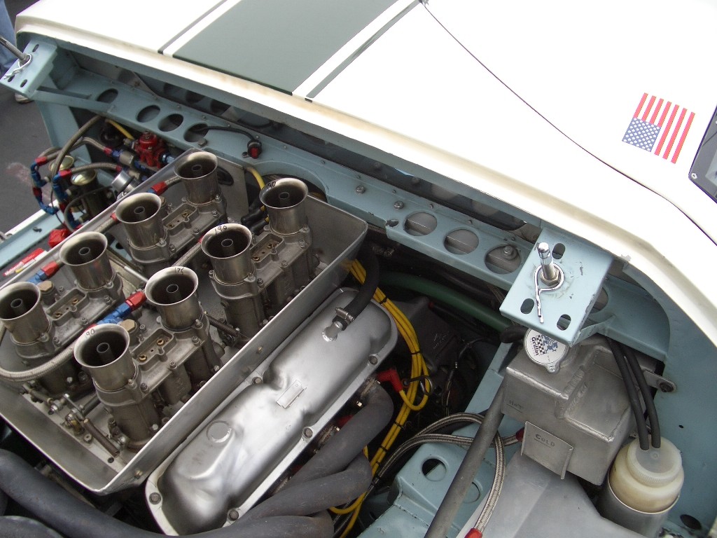

You should be able to get the engine with the smaller distributor cap under the cross bar on the firewall and forward a bit further. We did it on an EFI car with all the extra plumbing and harnesses to contend with too. Hope the picture helps...
