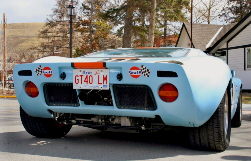

Do you know if they will be using these on the CAV's from South Africa? The side profile shot of, I think Bob Childress's guardsmen blue car is one of the most beautifully positioned in terms of wheel setting (IMO anyway) that I have seen. I personally love everything about the CAV cars except that weird wheel position - particularly at the back.

Autofutura has changed the rear uprights and lower control arms on new production. I expect the wheelbase would be adjusted at the same time. Bob has my arm's on his car by the way, getting the wheel into the middle of the wheel arch and more adjustability did it for him.
That is excellent to hear. I was thinking to myself after my post last night that in fairness, a lot of the CAV photos I have seen have been of cars that have no engine in them which I am sure, when added, would drop the back down a bit.
Regards
Jack

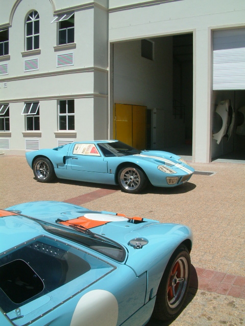

Hi Guys
Just to confirm that the chassis #100 and further runs with our new suspension, and needless to say all the components are of the best quality and design.The work that Ian is involved in , would be a upgrade for the pre #100 cars.
Attached photo showing the CAV GT stance.
Please contact me if you need further information or specs.

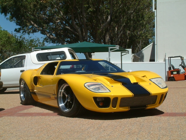

Are my eyes playing tricks on me, or these 2 cars are setup differently. Are the aspect raios different on the two cars? Is the suspension setup different with the yellow car sitting lower? Maybe the rear clip is different? Kinda looks different in the second photo in that the wheel arch looks higher??? I love the way the yellow car sits. Looks much racier than the blue car.
With the setup of the yellow car, are the spring rates stiffer for less wheel travel? Any fender rub issues? Just curious.
Hi Bill
Fair question. The yellow car is built with Race-spec....wide tail and lowered suspension. The wheel does not touch the arch.( 12" wide rims at rear. Second car is standard road spec, standard tail, 10.5" rims. ( 408 producing 565hp...) A beast!
Jean

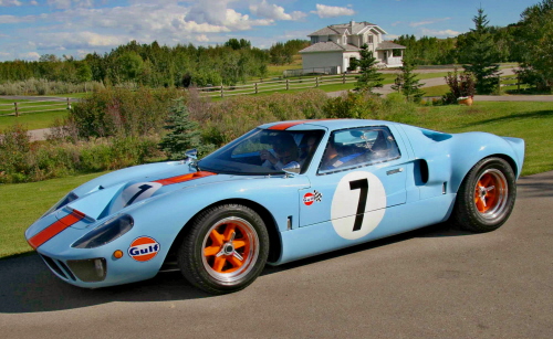

Bill,
I am sitting with chassis 109 three after Johann's blue one here. I have the new chassis/std body and 10.5" rims with 335 at back onn 600lb springs on the back with the CAV std. spring spacer. I have messed with the setup with Jeans guys and can get the 40 to sit right down in the arch with good ample shock travel capacity. I have excellent clearance in the arch and no experience of rubbing. What you see here is my compromise position to handle all the bleedin speed bumps in my street.
Would be interested to find out what is peoples perception of correctness wrt ride height....

Ah, the speed bumps! Ride height is like "limbo" how low can you go? 4" would be the minimum used on GT40 race cars in the sixtes. Our cars are happier on the road and over the bumps with 4.5>5.0" especially when running larger than 24"dia. front tires. Here's a pic of Johns right hand drive car, the first equipped with the new arms. Is that beautiful or what:)

I have installed this kit on my car, it worked out very well, suspension moves more freely and the wheel is centered in the well. I removed the spring spacer from the shock and now the ride height is correct. It is way quicker and easier to adjust the rear toe. All in all worth the price of admission.

I will post some photos but to answer some of your questions,
The springs are as metioned 600lbs running on the SPAX for the GT, uncompressed 197mm and 172 under load, spacer 20mm and 5 threads exposed to the lock nuts. Right now (because of speed bumps) I am running with tyre top 45mm beneath the wheel arch. Correct me if I am wrong but assuming you are running the tyres close to the edge you want very little compressive movement to avoid impacting the arch. Ths is kind of why I chose the 600lbs.....But the cost of springs wont prohibit changing as required.
The distance from the outside of the bevel on the knock on to the outside of the upper arch is 95mm from the same point from the knock on adapter to the inside wheel arch bulkhead is 270mm.
The distance from inside bulkhead to upper wheel arch inside is 365mm. The distance from the inside of the wheel to the inside arch is 80mm.
The car clearance I am running is 112mm and the tyres are 335/35 17's
Let me know what else you need
Steve
After installing CAV Canada (Ian's) lower arms kit, and machining the shock spacer/spring perch to 1/2", this is how she currently sits at the lowest setting. Still about 1.5" high for me. Shock's already sitting on the rubber bump stops.
