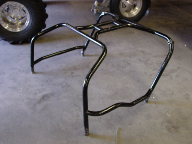

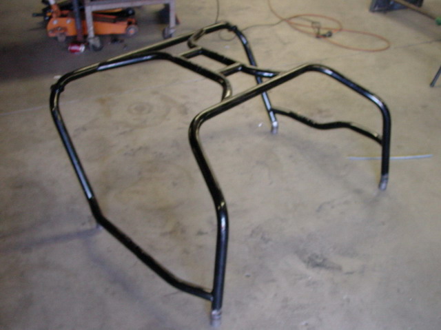

Maybe this will help

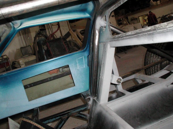

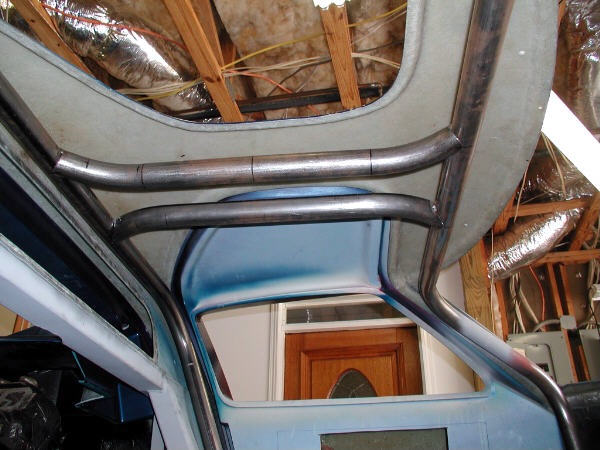

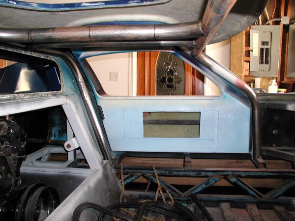

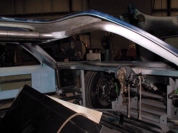

You will find as many designs as there are manufacturers(sp). If you want one in the car all the time, have it put in at the time of the build. Because of the shape of the cabin, a 6 point system seems to work out the best for forces in all directions. There is a company in Mount Olive, Alabama, Kirk Racing Products that make a roll cage that is detachable(read bolt in) that is certified for SCCA and other organisations. They were going to make my exhaust system at one time, but we couldn't get together on a convenient time. Talk to Mark Stewart. I will try to post some pics of my cage. Hope they make it.

That is the basic design. The only thing missing in all of the roll cages is some kind of triangulation. It is absolutely mandatory you add some kind of cross bar to avoid the collapse of the rool bar in a turn over situation. It can be a bar diagonally across the main hoop or a bar from the left side of the drivers head to the top of the left side sponson. In the later case it can be easily made into a removable piece.
