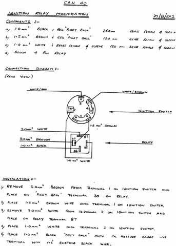

I think we've covered the ignition issue recently on the forum. There is a pretty simple test. Take the car on the road and turn on everything electrical at once. Wait about 5 minutes and if your ignition key it warm (mine was quite hot) to the touch, you probably need the upgrade. You can contact Roy Sayles for the upgrade kit or I can e-mail you a diagram to fix it yourself.

Veek, I think it would be a good idea to post the ignition relay mod diagrams in the gallery section here. Ditto for Bob Childress' pics that take it a few steps further with the A/C wiring mods. You both have been a great help to us CAV drivers.
I can attest to the necessity of these mods to the early CAVs. Very important safety issue as well.

Attached is the wiring diagram which comes with the ignition relay kit. I have a big warning that goes with it. NOT ALL AUTOMOTIVE RELAYS HAVE THE CONTACT SPADES IN THE SAME ORDER. They may look alike in the plastic bubble in the parts store but they are not. Check the relay to be sure the spade numbers are consistent with the diagram. If you don't you could burn up your wiring, your car and you! If you need to do the mod, my recommendation is you locate your CAV dealer and get the kit; that way the risk is eliminated. The relay I used is the Bosch 30A #0332019 451.

Let's try the attachment again...

Not a problem. I received an e-mail that the attachments don't show on some screens. So I'll reduce it one more time and see if that gets it. If you still need it, send me a PM with a e-mail address.
