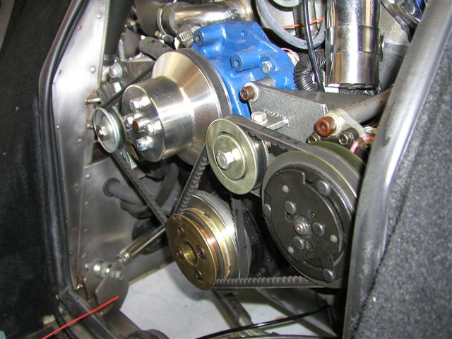

There's no easy way to feed the make-up air, however what we've done on all our cars is plumb the right side NACA Duct on the hood to the Heater/AC through the side of the cowl. Very tricky and time consuming but worth the effort.
There are no doubt other ways to do it, the key is to pump clean air directly into the blower, just getting some into the cockpit is not good enough to ensure fresh make-up air being mixed with the air already in the car.
As the factory CAV unit has four openings on the dual squirrel cage fans and we've dedicated one to make-up air, the ratio of recirculated to make-up air is about 75/25. This is greater than production cars however we need more fresh air since there's no cats and most of the CAVs have bladder fuel cells which are a bit smelly on their own.
Take a look at the pics, you may be able to copy this, just leave yourself lots of time At the end of the day, it will be worth it.

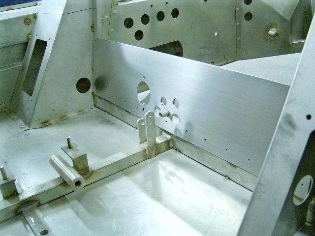

Ooops, Columbo moment... here's a pic of the firewall closing panel with the provision for a support bearing for our ZF Shifter Kit. These are stainless or aluminum panels. The sealing gasket is run along the top edge of the panel and all the holes in the lower firewall panel are covered.
