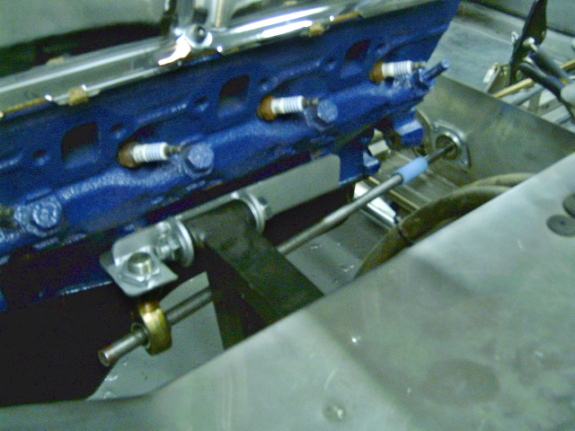

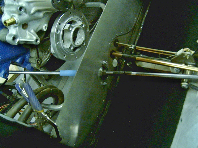

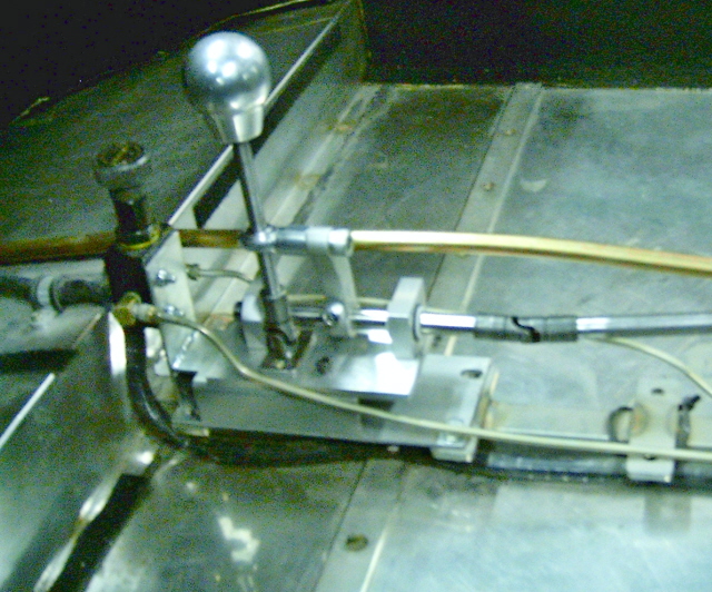

Hi Guys,
Here's more pics of the shifter in a car. By moving the u-joint on the intermediate shaft inboard we can get moe clearance around front accessory drives and the change to 5/8 u-joints and 1/2 rods save a lot of space and weight too.
The product is finally ready to ship It is meant for pre 100 cars set up for ZF or upgrading from Getrag to ZF.

Great looking set up!
