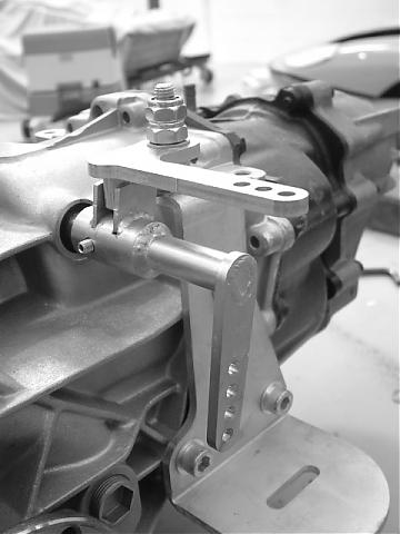

Can someone post a picture of the linkage and mounts used for 016 on a CAV.
I'm trying to figure out what Audi linkage and mountsI can get rid of.

Rich...trash it all from the 016...nothing gets reused except the slave
cylinder....and you're better off buying a new one.
You will need a special fitting to adapt the cylinder over to AN hose.
I got mine from Pegasus...but others sell as well.

Hi Tai
I have all the photos on file. I will try and post some here, but feel free to contact me on jean@cavgt.co.za if you need further information
