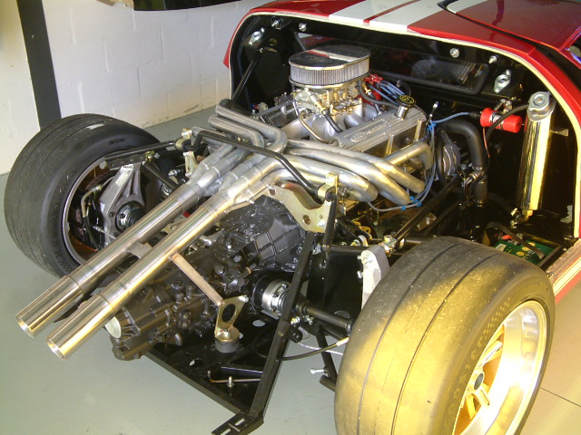

Would the Edelbrock RPM intake manifold be to high?

Edelbrock RPM works just fine...see attachment.
