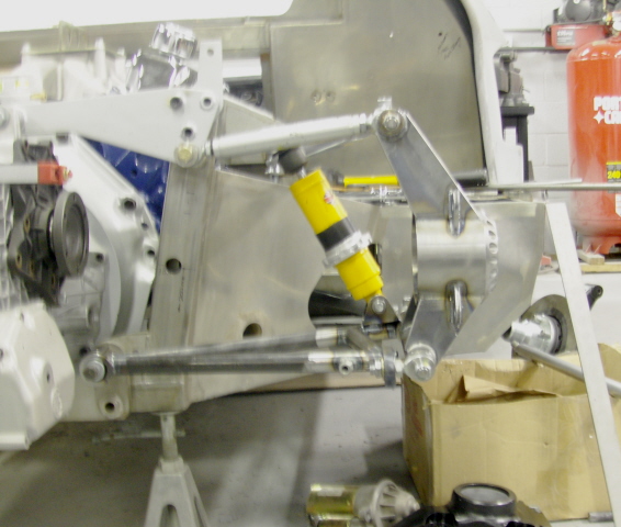

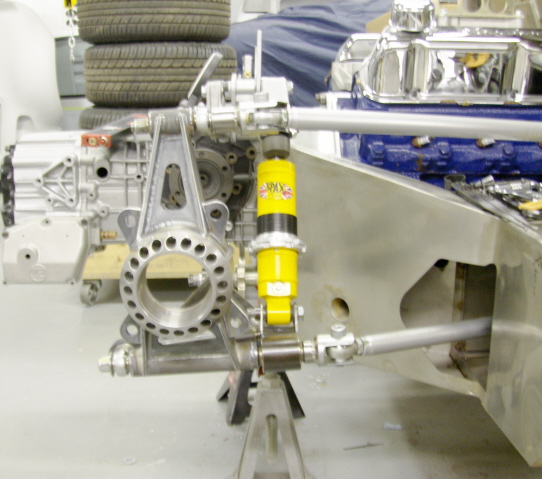

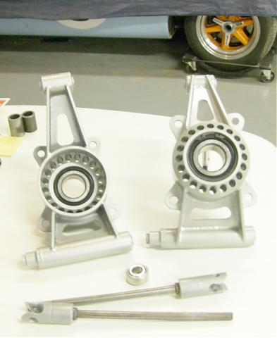

Thought some pics of our new Rear Uprights mounted on a chassis would show what we're aiming at with these parts. They weigh the same as the cast aluminum/steel mounting blocks bolted together assembly while being much stronger and improved cooling for the brakes and wheel bearings.
Like the new Front Uprights, these parts are intended for the "100 Series" cars made by or with parts from the original Cape Advanced Vehicles. Owners of post 100 s/n cars already have upgrades from Autofutura so these parts aren't applicable.
The new Rear Uprights optimize the rear suspension geometry in several areas: Camber climb, Roll stiffness, Coil/Over Shock travel, and work in conjunction with our Revised Lower Control Arms to give adjustable Toe-in and elimination of all binding from the rubber bushings replaced with Aurora Spherical bearings and rod ends.
The new Rear Uprights won't work on the stock lower control arms however there is a package price for buying both. The Revised Lower Control Arms will work with the existing cast upright though.
About Camber Climb, we reduced the height of the upper pickup point on the upright to reduce the angle of the upper lateral link. This cuts the rate of camber climb by almost half, meaning if you're running wide tires (295 >) the contact patch is better on the exit of corners so you can put down more power. Also tire wear is more even across the tread face, especially at lower ride heights.
About Roll Stiffness, by lowering the pickup point of the lower control arm on the upright the axle center went up and the lower control arm becomes horizontal or droops slightly downward at the hubs depending on ride height. By making the lower control arms horizontal to slight droop we raise the instantaneous roll center, thereby reducing the lever arm length which the sway bar controls weight transfer side to side.
The result is a flatter cornering attitude without increased ride harshness that would come from stiffer bars or springs. The roll stiffness has improved geometrically rather than mechanically. Same effect, without adding NVH, noise, vibration and harshness.
About Coil/Over Shock travel, simply lowering the pickup point of the lower control arm extends the shock length, gives back almost .750" on our existing A-Arms. A shock absorber mount modification on the jig means our new production A-Arms will have a full inch more travel.
Note how the shock mount on the lower arm is angled to match the rear castor (anti squat angle). This keeps the bushings in the coil overs free.

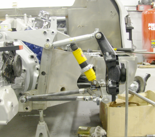

There are pics of the stock uprights installed (with our billet mounting blocks to fit the new arms) so you can see the angles compared to the new parts.
We've also revised the tooling for the new upright since the last postings so any brand of brake caliper/rotor can be accomodated. Shown are the standard PBR mounts, however AP, Brembo, Wilwood... no problem.
Still three choices of colour, black, aluminum or charcoal metalic. Still a core credit for the old uprights too, but you do get new SKF bearings of course.
There's a lot of potential in the CAV monocoque chassis, it's a really strong part. The purpose of these new suspension components it is to give the pre 100 series cars the absolute maximum performance from the chassis using bolt on parts and only hand tools required.
If you're doing any lapping days or plan to track the car occassionaly, these are must have parts. Enough techno-bable, how do you like'm?

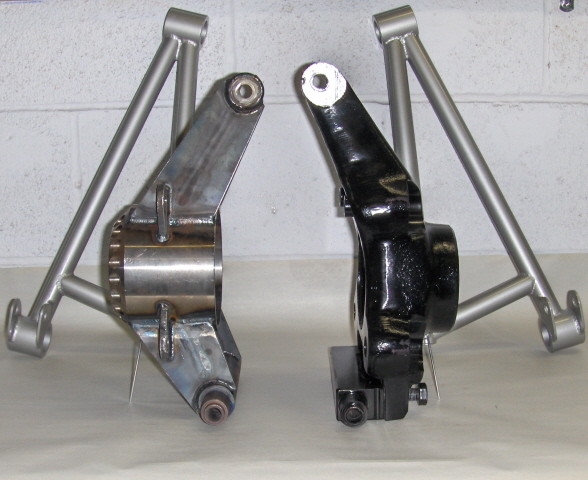

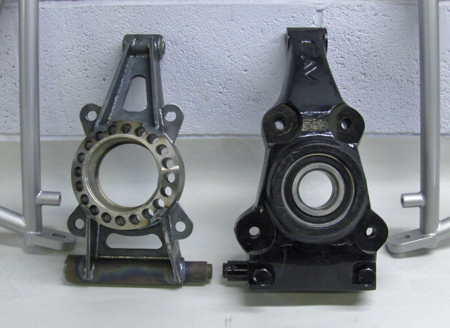

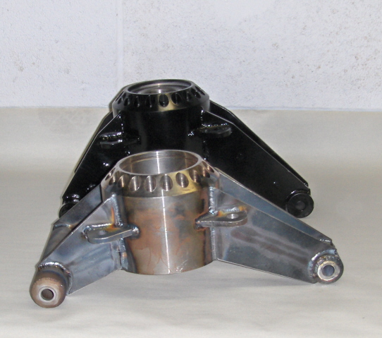

The pictures below show in more detail the differences between our Steel Uprights and the old Cape Advanced Vehicle (pre Autofutura) cast upright. Also we are producing a Wide Track Rear Upright version that moves the 10" wide stock offset wheels out to fill the Gulf arches - no more Buick Roadmaster fender overhangs!
The unpainted part gives you an idea of what goes into these uprights, they are brutally strong yet weigh no more than the cast aluminum/steel bolt together parts they replace.

Jac, On the surface it would seem the simplest solution to track width while keeping 10" wide wheels would be to increase the length of the upper lateral link and reversed lower a-arm. In fact our control arm jig has the provision to make both lengths and we have cars so equipped. So our first version went as you suggest.
When the first wide track conversions were done we were still using the original old pre Autofutura uprights, our CNC Steel part didn't even exist.
After closer examination of the relationship between the change in suspension operating angles (as the inboard lower pickup points also have to be moved to keep the trailing arms from touching the sill boxes) keeping the arm lengths the same and manufacturing a dedicated upright made more sense.
Having done so, and used in combination with the new Lower A-Arms the suspension is optimized to the limit dictated by the chassis pickup points. Really a good working setup.
Cliff,
The original cast uprights from Cape Advanced Vehicles (pre Autofutura and pre s/n100 cars) are fine for pleasure drives when properly installed and maintained.
The problem is that in order to align the toe-in shims must be installed under the rear most mounting bolt of the steel block that goes across the bottom of the casting. Since both parts are machined flat and parallel something has to give to make up for the shims.
Deflection forces are absorbed by the casting and steel block, you can probably quess which metal fails first.
Anyways we designed the new Steel Uprights to improve the geomtery to improve traction, thereby performance and balance, as well as provide a stronger mount for the bearings (we've seen oversized and egg shaped bearing bores) at the same time.
In the process of making it light, the ring of holes around the bearing bore also reduces heat soak to the bearings from the brakes and improves cooling to the brake vents, both obvious benifits. Hopefully this will increase the life of the CV joint lube as there has been boiling of the lube which leads to a joint failure (under track conditions).
The new Steel Uprights came after the Reversed Lower A-Arms so you can see how one improvement creates opportunites to refine other components in the vehicle system.
A customer with all the all four corners on his car, and an experienced racer too, said that a completely stock CAV GT was "scary" to drive in comparison. It certainly underscores why the new Autofutura CAV GTs have been so impressively upgraded and owners of the early style (pre s/n 100) cars are opting for our performance upgrade parts.
To be fair "scary" would be at track speeds, although guys who never drive their cars in anger report the car feels better to drive just around town. CAV Canadas' Race Parts are designed first and foremost as performance improving components, in the case of the uprights, you get a vastly stronger part as well with no weight penalty on the rears, with the fronts being about 2lbs heavier for the pair.
Again, kudos to Jean and Jean for the fabulous work in taking the production CAV GTs to a higher level, our Race Parts are meant only for the pre s/n 100 cars.
