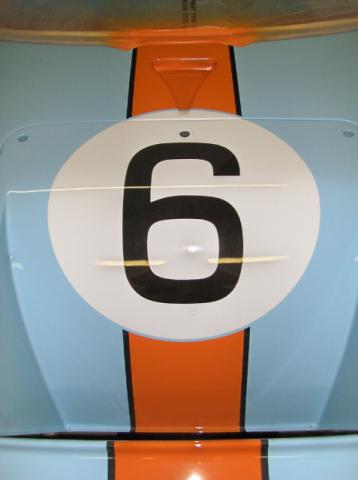

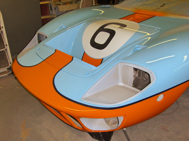

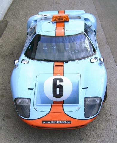

Here's something along the same lines, detail work on Angelos' CAVGT1075. We're going hard core here with major refitting including all suspension updates, converting to right hand drive and respray to correct 1969 LeMans layout.
So the headlamp and driving lamp recesses will be semi-gloss black with black surrounds rather than the black upper and orange lower as in the pace car pictures.
It's amazing how much more visual impact you get from the roundels, numbers and logos even over the stock car. Also the wide track rear suspension fills out those giant Gulf flares.
About the roundels and numbers, we've gone with base/clear on both. The removable hood section was quite tricky to do as the roundel intersects the edge/gutter and there's a small gap between the orange stripe and the circle. Yeah, we blew through a few rolls of 3M Blue masking tape! Although still covered in the pic, the center Nasa duct has been opened up.
Also the narrow stripe between the powder blue and marigold orange is now dark blue and the sweep of the stripe as per '69 LeMans, the wrap around starting on the nose and rising over the side markers. We've also eliminated the left side Monza filler cap but that's another story
