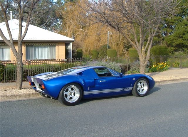

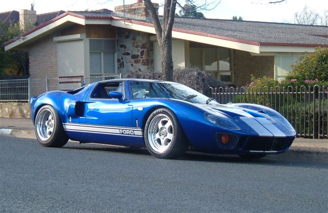

Well here's another DRB on the road. Finally registered in South Australia. I think the first one here.
Registered here with standard 5.0L HO 1989 Mustang motor and EEC-IV.
Its taken me a while but finally the project is finished.
You can see in the attached pics that its sitting a little high - this was to keep the minimum 100mm ground clearance, so i pushed it up to about 110mm just to make sure.

One more piece of eye-candy for Australia!
Great accomplishment and beautiful color - well done!

Looks beeaauutiful. what wheels did you get as they look like the ones i have been chasing for my drb17 although in a different colour.

Yeah! good job Chris --its almost vintage already--finally, you can go cruisin'. Enjoy!
Greg -- looks like Simmons wheels just like the Orange ones you have

Congratulations mate, I like the colour.

Good to see you got it finished. Hopefully mine will get to that stage one day. It looks fantastic in its new paint and will inspire me to get out in the shed and work on mine. Great job. Hope to catch up with you soon.

Hi Chris,
Congratulations !! The car looks superb & I love the colour (no bias here !!). Did you end up using that old stock Mustang induction setup for rego ? Any plans to "work" the motor now that you have got rego ?
Now comes the hard part - what to do with your spare time - finish off all those minor outstanding items, or just go for a drive ! 4 years after my rego, I still haven't got around to a professional carpet job, headlining, decent handbrake, etc !!

Thanks for the compliments. I am stoked its finally finished.
To answer some of your questions. The wheels are Simmons, F90 - and I matched the silver stripes over the body to the centre colour of the wheels. A small touch but makes a difference. The colour is from the Nissan 350Z. Simmons have the specs required for the DRB setup. ie required offsets etc.
Peter: yes i did use the manifold you sent me - worked a treat - no questions. Just painted it nice and black to hide anything which may have attracted attention. Well now the manifold comes off and the 8-stack goes on. I have got the Autronic ECU, and thats going on next. What setup did you use on the ignition side? I have an auto elec mate who is putting this together for me now so would be good to know what setup you have? Individual coils? Did you need to put in any additional sensors - ie crank position sensor?
Now i have driven it - i would like to improve the brakes - cant seem to get the f/r bias correct, so may have to go to the tilton setup with balance bar. Need to get the electronics and that sorted first then i can take it out on the track to test it comprehensively.
As for other minor outstanding items, the car needs to be pretty much complete here in South Aust, so i have got basically everything done from interior to hand brake. The only minor thing outstanding is gassing the A/C. I have a leak somewhere and cant find it, so I forsee will be multiple hours sourcing that!
