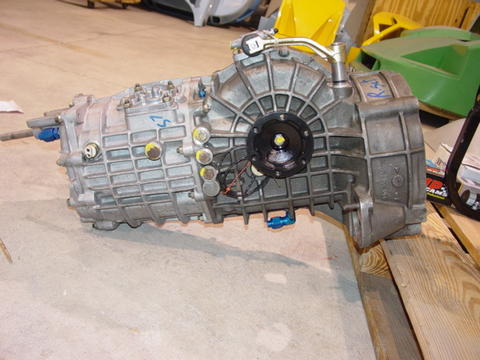

Not a very good photo. I'm not sure that the tranny shown actually is a 930. I could be wrong but I wouldn't want any GT40 guys to get caught out if it was not the turbo box.
IMHO potential buyers should verify that it is indeed a 930 they are bidding on. More photos, serial numbers etc. for clarification.
Maybe someone who is more familiar with Porshce trannys could comment.

I think those photos confirm it's a differemt beast. Look at the radial ribbing around the output shaft and the horizontal ribbing on the gearset housing. Buyer beware!

You're looking at a 4 speed from a 1979 turbo 911 - it is correct for that year. The later 4 speed from '86 onwards did have some improvements to address the higher output of the later turbos - and that's what you might be seeing in the comparison photo. I wouldn't be concerned about authenticity of this transaxle.

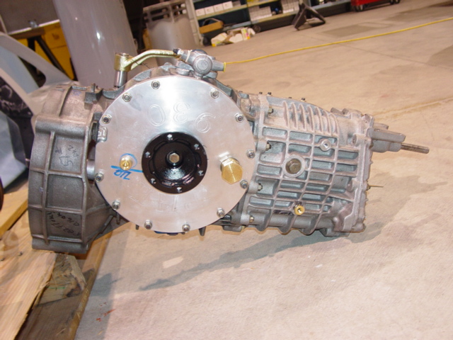

Definitly worth getting the serial numbers. I have seen a few 930 boxes and none have the fine case ribs like the pic, but I have only likely seen some of the later ones. Attached is my gearbox, and all that I have seen look like this FWIW.
