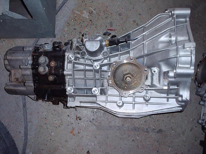

Picture of a Fwd 01E at right side. Looks not the same as 016.
