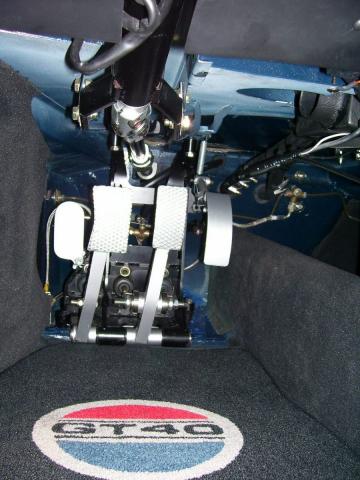

I got my pedal box from the machine shop today. They remachined the balance bar and pressed in the bearing I got from Aurora, and I was able to assemble it. I have asked Jay to pay the cost of this, plus I have again asked him to ship the parts that I need to finish the sway bar installation and complete the pedal box and get it in. (sway bar bushings and captive nut plates for the pedal box installation). I've also told him that I will dispute the last charge he made to my credit card (to which I've notified him he can no longer charge ANYTHING) unless I get a satisfactory resolution to all of this. We'll see how this turns out.

Have you found another source for the dead pedal? If so would you share your source? Thanks.

I think Gelscoe in the UK have the dead pedal; look on their site or look at them using Google.

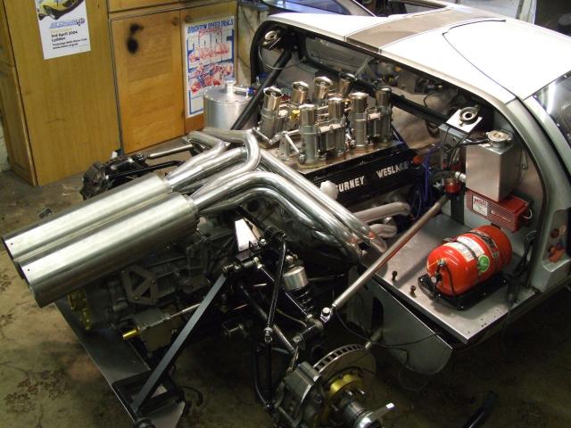

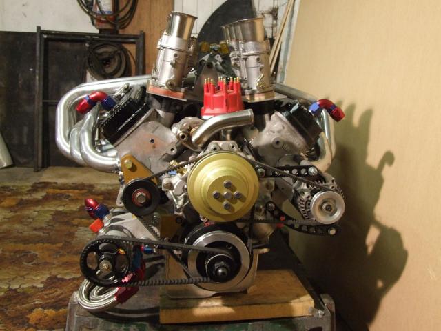

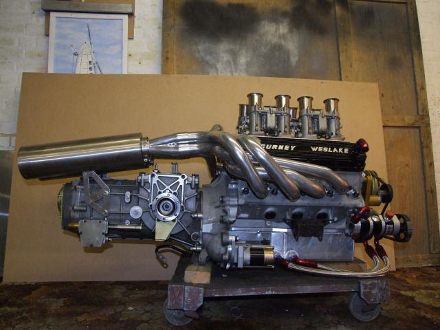

Finally installed - I am sure Martin will update you with the tale of this Engine, Frank

Frank and Jim,
Good show! Please tell us about the dry sump system.
