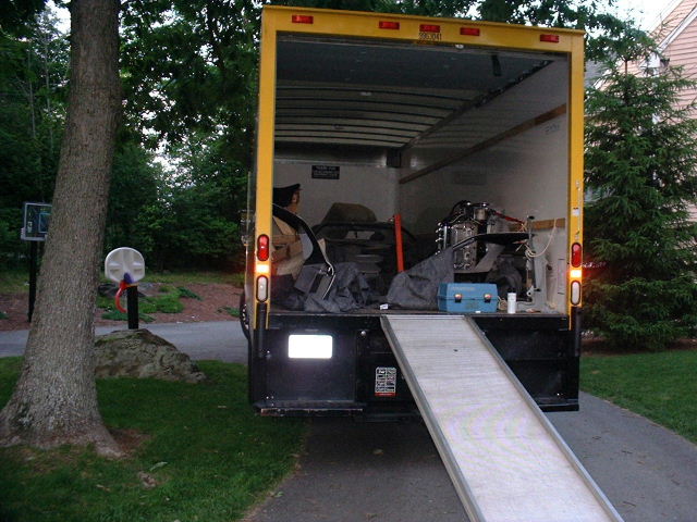

Since I still haven't put a web site together I might as well throw a few images here in this post and document my build. Since I've posted several progress reports on my GT40 over at my other favorite automotive web site, www.corner-carverys.com/forums, I think I'll just cut and paste some of what I posted over there.
But first, a little about my GT. Like many others in this forum, I fell in love with the GT40 when I was a kid. I strted looking into replicas in ernest in 2001, and was fortunate enough to buy Bob Lawrence's kit in June 2002. Bob had started building one hell of a show car. Frankly, I was intimidated about carrying on the construction up to the standard he set. This car happens to be the first RF that was imported to the USA. Here's a picture of the car in my driveway when I got it home from Dallas:

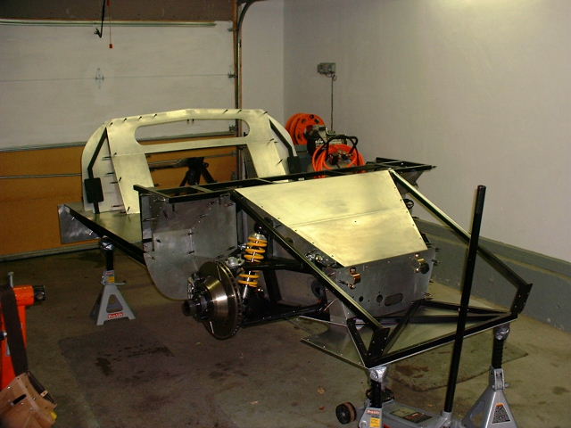

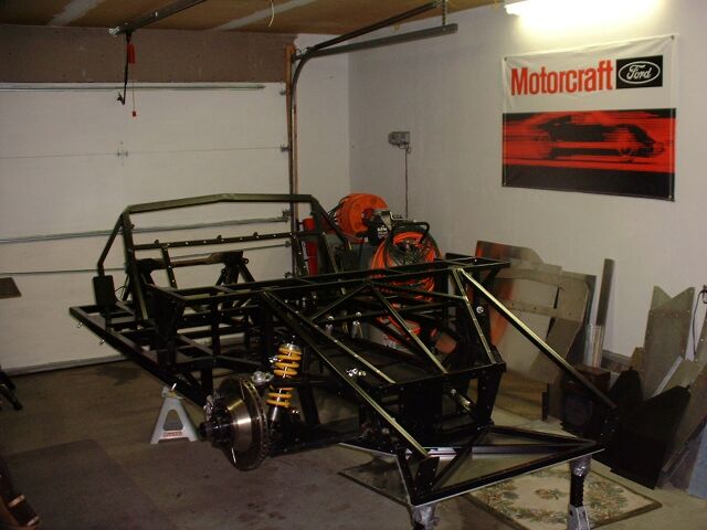

After fitting, trimming, refitting, re-trimming, drilling, clecoeing, removing, etc. the panels more times than I care to think about, I got everything off to the bare chassis in April 2003.

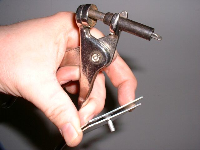

Old 11-03-03, 12:16 AM   #5 (permalink)
Mark Worthington's Avatar
Mark Worthington
Join Date: Dec 2001
GT40: Massachusetts
Posts: 1,789
Re: Roaring Forties #36 - Mark Worthington\'s GT40

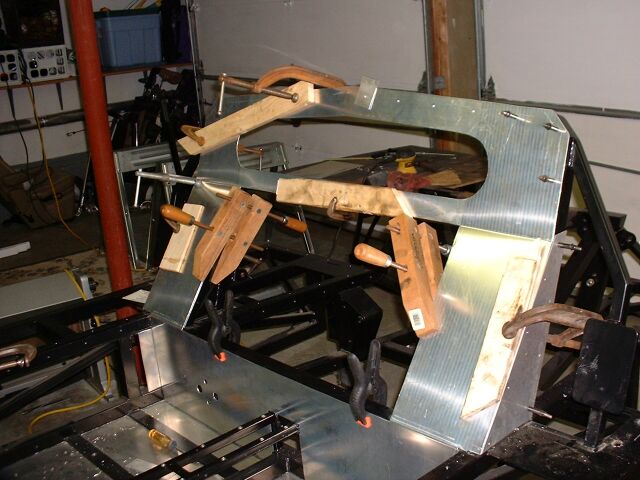

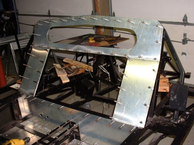

In the next photo I've clamped the bejeezus out of the rear bulkhead to keep it from warping (one of the problems with the original panel). You can see my blind chassis hole locating jig in action...
Name:	24238-clamping and clecoeing new rear bulkhead in place.jpg

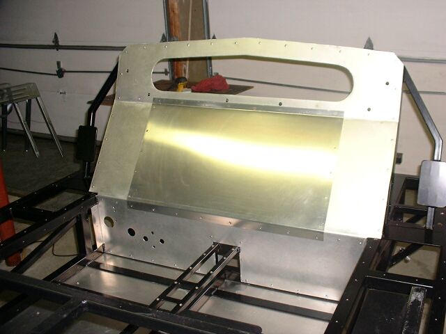

And here's the finished rear bulkhead, along with the fitted engine access panel (which in and of itself took another weekend to fabricate and fit). The engine access panel is held in place with countersunk 8-32 x 3/8 stainless machine screws which screw into rivnuts installed in the chassis tubes. I used Cherry Q rivets everywhere I could on the rollbar, because that is the one piece of structure I really don't want to fail. I had to file the mandrel down flush with the rivet head on each one. I'm using plain, low-strength sealed rivets elsewhere. In addition to riveting, I'm also bonding the panels to the chassis. Man, it was nice to actually start using rivets instead of clecoes. Progress!

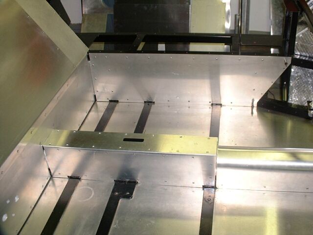

Here are the panels I made for the water pipe tunnel, all removeable thanks to rivnuts and countersunk screws...

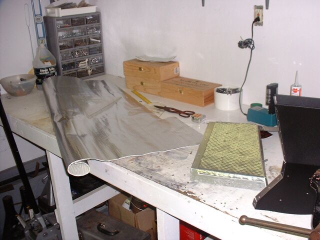

Old 11-03-03, 12:24 AM   #9 (permalink)
Mark Worthington
Join Date: Dec 2001
GT40: Massachusetts
Posts: 1,789
I'm using an acoustic/thermal insulation product called ZeroClearance...it has a heavy foil and silica/polyester with a super sticky adhesive. You cut it to fit, peel the backing, and stick it on. It'l help keep heat out (GT40s can get toasty inside) and I hope it'll keep the interior reasonably quiet and prevent drumming of the larger panels. I'm using it on most all of the panels that face the interior. You can find it at www.coolandquiet.com. I'll probably add about 15 pounds to the weight of the car with this stuff.
Name:	24242-insuating wheel well panels.jpg

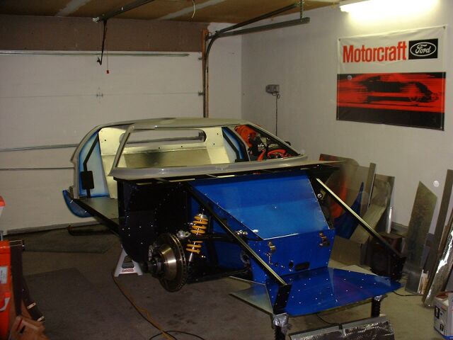

Finally, I had my aluminum panels powder coated. I used a translucent blue color by Tiger Drylac called Candy Blue. After messing around with polishing for months, I punted and ended up prepping the panels with a fine Scotch Brite pad in a random-orbit sander. These pictures do not do the color justice...they came out looking fantastic.

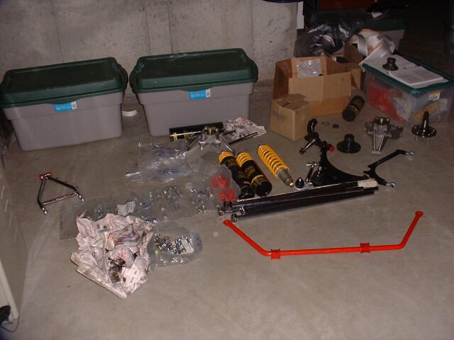

After the panels were fitted, I installed the rear suspension on my car. The next picture shows a bunch of junk in my basement that became my rear suspension. Everytime I bring something up to the garage I consider it a small victory. Remember, the right front suspension was already on the car.

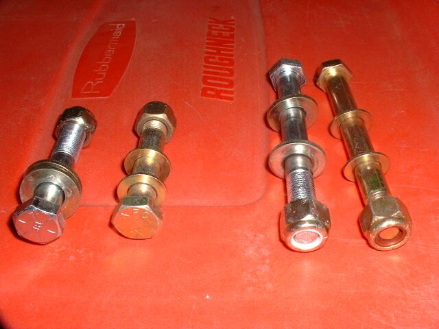

Old 11-03-03, 12:43 AM   #12 (permalink)
Mark Worthington
Join Date: Dec 2001
GT40: Massachusetts
Posts: 1,789
I probably didn't have to, but I upgraded all critical suspension fasteners to AN and NAS hardware. This next pic the AN8 (1/2 inch) stuff (Cd plated) next to the stuff that Roaring Forties supplied. Here's to you, Carroll Smith!
Name:	24246-AN8 fasteners vs RF supplied.jpg

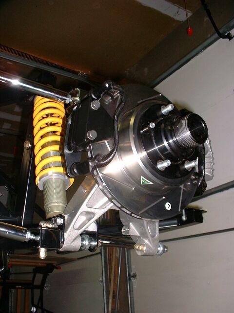

Old 11-03-03, 12:51 AM   #14 (permalink)
Mark Worthington
Join Date: Dec 2001
GT40: Massachusetts
Posts: 1,789

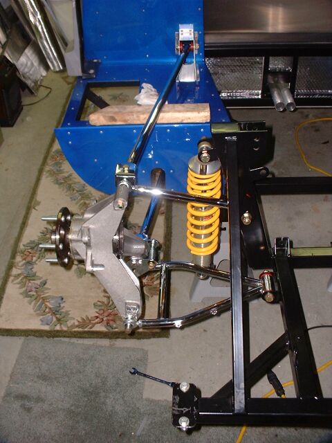

Here's the rear suspension setup on my RF. The upper and lower drag link front ends attach to chassis mounts near the firewall with AN8 pivot bolts, and the drag link rears attach to rod ends which attach to brackets, that have a high-tensile 3/8" bolt welded to them. The lower bracket goes through the lower upright, through the lower arm, and through a bracket which makes this a double shear attachment and the bracket also serves to locate the lower damper mount. The rear end of the lower arm mounts to the upright in single shear. The rear of the upper drag link mounts to a bracket which has a high-tensile bolt which runs through the rod end on the outboard end of the upper link, which then mounts to the upper upright. All the 3/8" fasteners use high-carbon-steel ferrules (sp?) where they attach to the rod ends...the ferrules effectively increase the diameter of the bolt and distribute the load.
I posted another thread on this forum about the pros and cons of chrome-plated suspension bits, but have researched the matter and concluded that, for a car that will only occasionally see track duty and that will be frequently inspected, I am not concerned about the chrome plating.
Name:	24248-left rear suspension with brakes.jpg

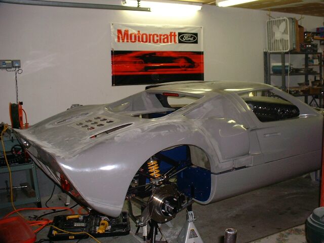

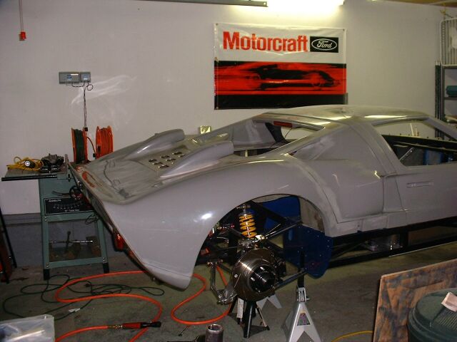

I took four days off of work in July 2003 to work on my GT40. Hershal Byrd was kind enough to accept my invitation to come out from Phoenix to help me with the fitment of the body panels. I can't say enough great things about Hershal...he is truly an amazing guy. My wife was reluctant that I had invited a "stranger" into our home, but she absolutely adores Hershal now, and we all look forward to when we can visit with him again (February 2004 in Arizona). Hersh is a true class act and his help probably saved me three or four months of head scratchin', cussin', and bein' pissed off at this body work stuff. Hersh is so knowledgable about so many things, especially cars, and especially body work.
The next picture shows the rear-clip-to-spyder-to-door relationship of the various body pieces. It doesn't look too bad in this pic, but there are minor misalignments that need to be fixed with filler and my new DA sander. I have to be careful not to drive myself nuts trying to get the body panel gaps to look like a Lexus. The original cars were actually pretty damn rough. I've decided to paint the car a bright white with blue stripes. I like the stripe scheme that Hershal used and will copy it verbatim, only in Daytona Blue (A Nissan color on the new 350Z). I think the white color will really bring out all the gorgeous lines of a GT40, but it will also highlight any flaws in the panel fitment.
Name:	24250-Body fitment 005.jpg

Here's the car after Hershal departed, showing off that purty body work. Damn but it is a gorgeous car. Since then I've cut out and mounted the headlights, driving lights, perspex covers, door hardware, and done some more work on the brake system. I have enlisted the aid of Bill Hough (AKA Datonabill) who lives nearby to help me fit the Gulf flares next weekend, so I hope to have a nice update in about a week.
